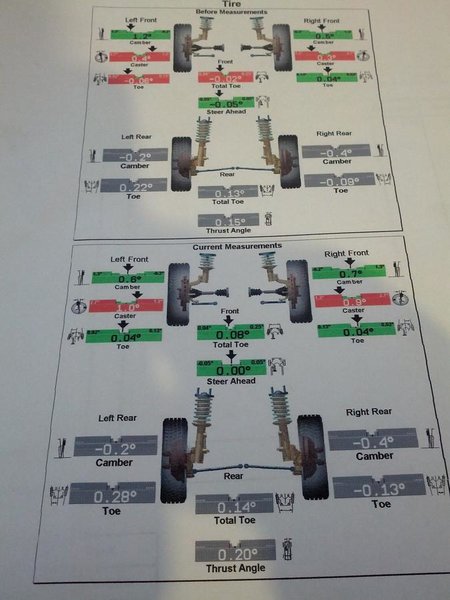

    So what caused the camber to go so negative? The UCAs or the spindles? Actually, even though those number are out of range they may not be half bad. How does it drive?

    It drives fine. I am worried about tire wearing too fast... And they are saying it is the uca's which I agree with because with the Light racing uca's they were fine...

    You might be OK with frequent tire rotations. Keep an eye on the inside edges of the front tires. Use the coin depth gauge to compare the inside groove with the outside groove.

    Thank you for your help. Any other suggestions? Maybe see if I can switch out the UCA's with the other set I posted?

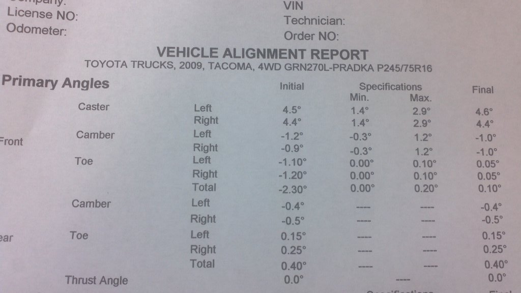

    I just picked up my truck and they said that they got it lined up. But just looking at it, seems like the _tires are tilted.

    They should have given you an alignment spec sheet with all the numbers. Scan it and post.
    Do the wheels look like this \---/ or like this /---\

    They said there printer has been down and the wheels look like this \---/ but not slanted that much. I was going to ask the alignment tech about the specs but everyone was gone except the 2 women eho work up front.

    That's called positive camber and normally there should be a very small amount of it. It actually helps with tire wear to have that small amount of positive camber to offset the small amount of negative from the rears. The amount should be so small that you should have a hard time telling just by visual.

    Looks about right then
  20. Jun 20, 2012 at 5:33 PM
    #140
    xyourlocaldjx
    xyourlocaldjx Well-Known Member
    Dec 22, 2009
    #27990
    433
    hows my alignment look? said it was the best he could do and that it was maxed out?
    My caster is pretty far from what i wanted at 2.4
    it used to pull a little left, now it pulls a bit right.
