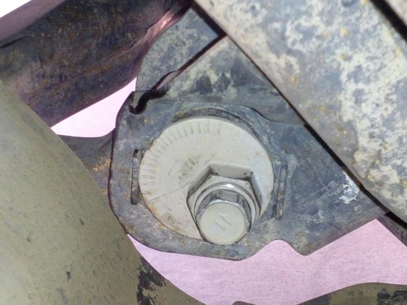

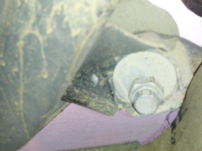

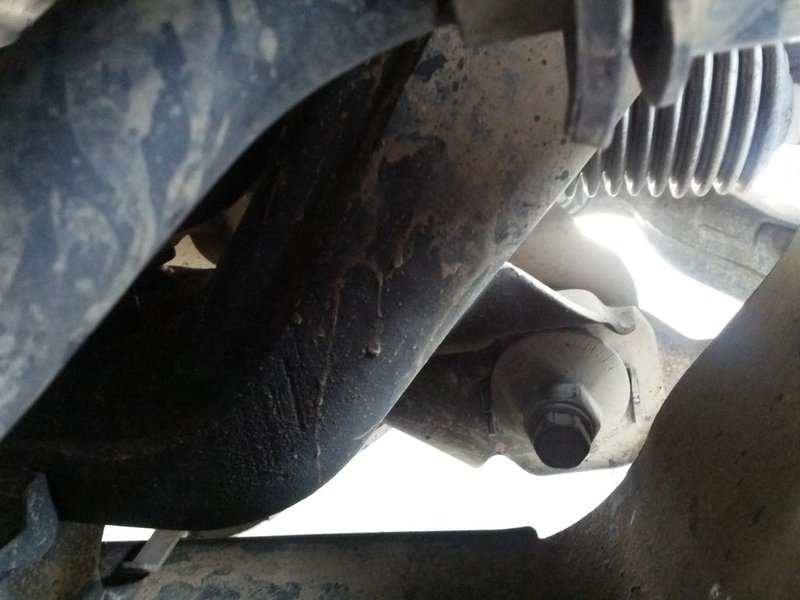

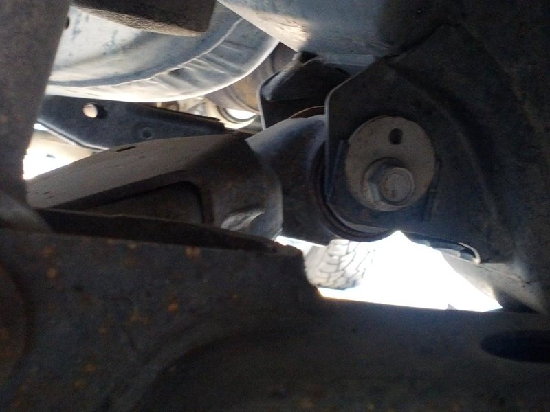

    Thats really hard to tell which cam is which (ie: front left, rear left, etc) but 3 of them are in the middle and the other one still has some left

    the first two is front and the rest are the rear. damnit guess i got to go back tomorrow.

    My cam tab is maxed at -1.7 camber even after a new alignment...caster is 2.6. if I lower caster to 2 will I gain camber?

    Front or rear cam is maxed?

    and one one my damn cam tabs is bent.....in the pic above....fuckkkk

    Tacoma with some stuff melted to it
