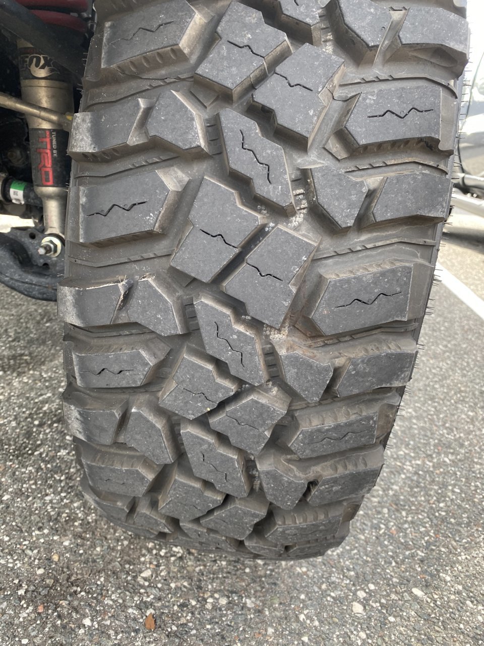

    Drove some more today it’s a little better
    I ordered 1.25 inch spacers
    hoping this will help with uneven/ sides wearing too

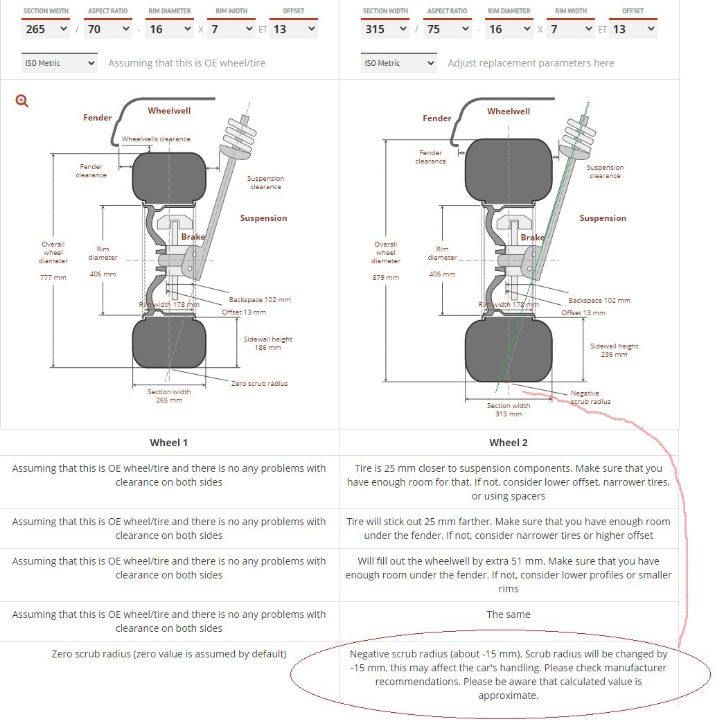

    Here is a graphic of what's happening with the negative scrub and my recommendation of a wheel spacer. This would be a front view of the passenger side.
    Tire height alone gave you negative 15mm of scrub(red). This is where my original 3/4" spacer recommendation came from.
    The increased SAI increases negative scrub a bit more(green). You'd have to due some measuring and trigonometry to get a good idea exactly how much. You might assume I figured 3/4" based on my 1.25" spacer recommendation. It was more or less, because 1.25" is a popular size and even if it gave you positive scrub it shouldn't be significant. It's better to have positive scrub than zero or negative scrub, on a rwd wehicle.

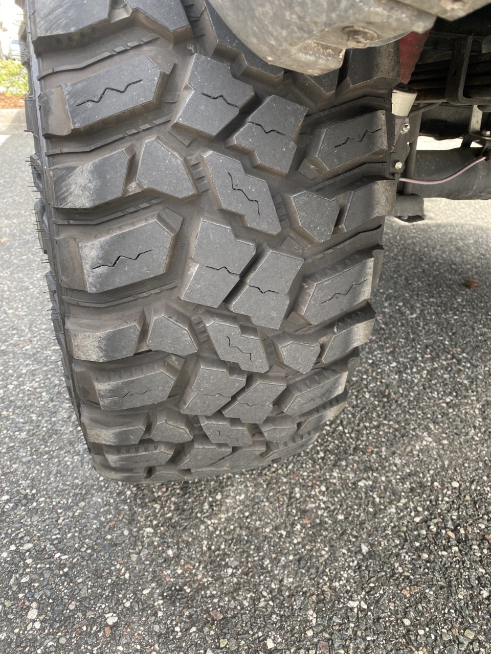

    The outer edge scuffing on your new ones are quite pronounced.
    This looks like camber change due to higher caster and/or non compliance due to the narrow wheel/wide tire combo.

    really appreciate the feedback. My duratracs wore like crazy on the inside to the point where the outside tread looked almost new and the inside tread was basically drag radials.
    my driving depends typically it’s city with some turns. But then I do a long road trip with a few 100 miles every couple months. I offroad probably one or two weekends out of the month.
