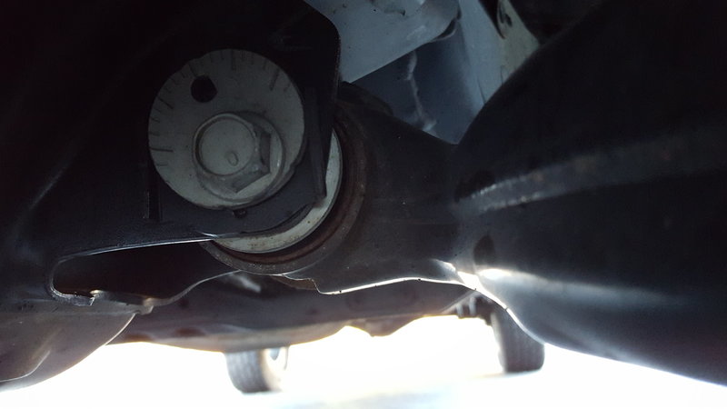

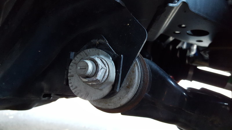

    Here are some pics of the front and rear camber and caster bolts first 2 are of the passenger side

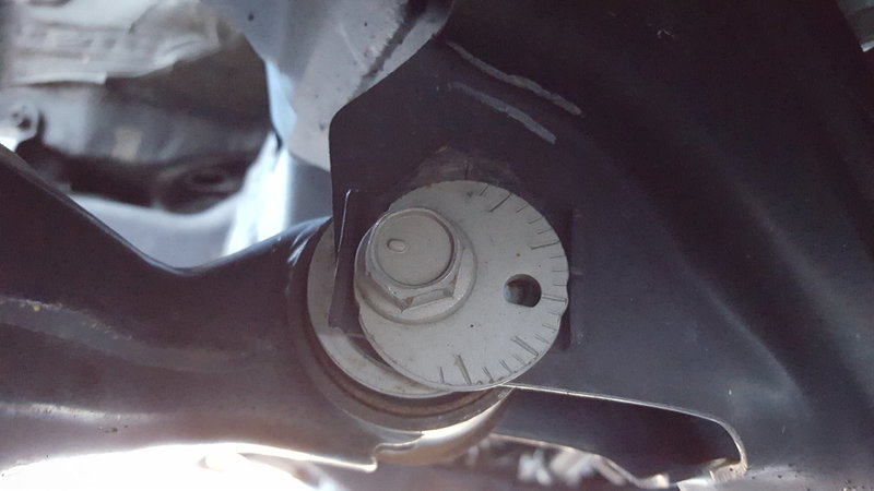

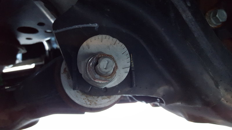

    And here are pics of the Drivers side Camber and Caster bolts

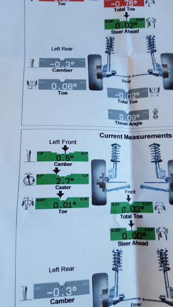

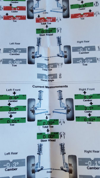

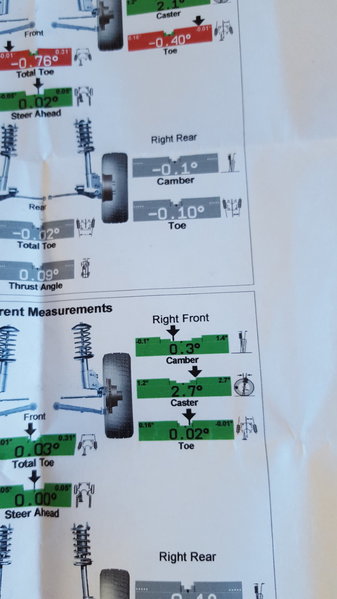

    So I figure I will go back in a week and have him bring it 2.2 Caster and 0.0 Camber. Any other numbers I have him change like the toe? Make it 0.1 Toe on either side? I will live with the lower Caster until I sell these for maybe something designed to give a little more Caster.

    Okay but definitely have it go back to 2.2 Caster and 0.0 Camber. @Blackout14 Hook a brother up with some new arms man

    OP - let your new springs break in and settle for a few weeks before you go back for a touch up on your alignment. Bounce the front end a bunch on some speed bumps etc to break them in, they could easily settle down 1/2" or more which will in itself change your alignment #'s quite a bit.
