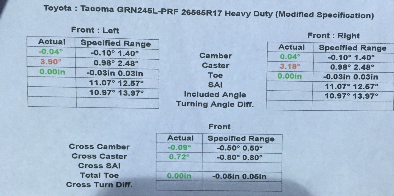

  15. Nov 20, 2015 at 10:29 PM
    #235
    sect0r
    sect0r Well-Known Member
    Nov 12, 2013
    #116437
    165
    Oregon
    14 TRD Sport
    King Mid Travel, BAMF w/ 12" King's, ect
    I got these numbers with TC UCA's and kings set at 2" for now. 44efd00554dcea261cc30e3789349c6f_88df9d1cf59b88af3724a1ead5e60ef12ac38630.jpg
