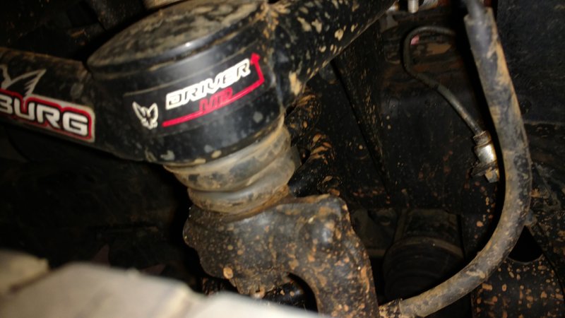

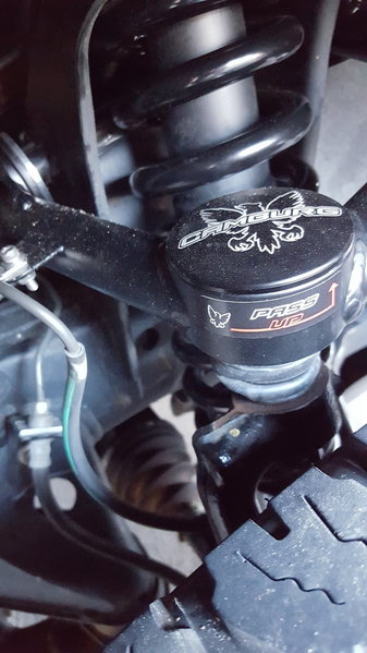

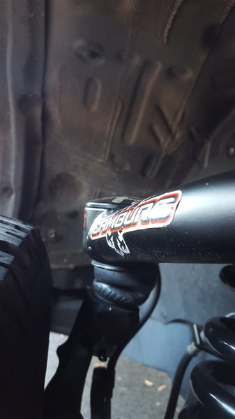

    @Unchained 5150 can you list a picture of the your UCA ball joint boot? I'd like to compare how it sits to mine.IMG_20151116_191015873.jpg

    #106
    motoxscott
    motoxscott Well-Known Member Vendor
    Dec 7, 2010
    #47337
    200
    Scott
    Socal -> Hurricane, UT
    2017 Tundra - 2008 Tacoma
    The boot design MOOG does on the Tacoma ball-joint isn't multi-ribbed like a CV boot so it bunches up like that ... that's pretty normal looking. Make sure it's not pinched down in the tapered hole when it got installed though. To a certain degree it floats on the stud portion so it doesnt get twisted up when turning.

    Arcticelf
    Arcticelf Well-Known Member
    Jul 18, 2015
    #159735
    7,653
    Gladiator
    Okay. @Unchained 5150 's look like mine.
    I did check that the boot wasn't caught in the spindle hole when installing.
    AE
    motoxscott[QUOTED] likes this.
