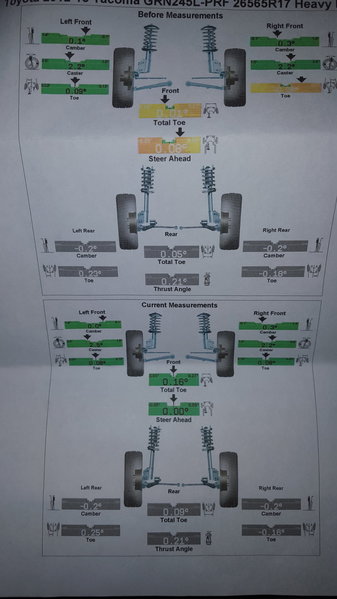

    I will post my spec sheet when I get home. But go with Light Racing you are better off

    So blackout just got 3.1 castor on each side with his new JBA upper control arms and the positive camber of 0.5 on both sides

    Please post pictures of all 4 alignments cams so we can get the full story before you keep calling out vendors on here. Alignment spec sheet isn't that helpful.
    The arms do in fact add caster, sounds to me like there's an issue somewhere else if the cams are truly maxed out. Something's bent, frame was welded on a Friday, who know's. The only thing that Camburg should clearly state is the amount of castor the arms are suppose to add all things being equal, which is simply how far back they moved the ball joint.

    Just because I thought they were the better choice and to try something different from the last time. Really thought I would have gotten better alignment specs out of them though. Oh well it is what it is. People keep telling me the 0.4 and 0.5 positive Camber really isn't an issue, we shall see
