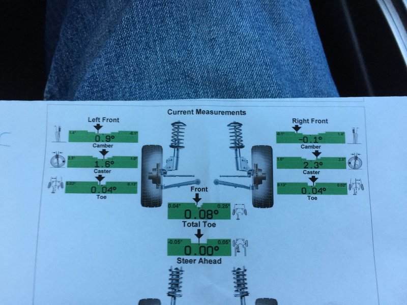

    image.jpg I was looking for some help on the alinment topic. I have always been able to get pretty much perfect alinment since I switched to total chaos ucas. But over the weekend I changed out my shocks for kings and went in to get an alinment. When I picked up the truck it was rubbing horribly on the drivers side only. (Actually touches frame on drivers side with slightly turning.) the passengers side is fine. I tried to ask the shop about why and was pretty much cussed out... So I just left after paying...
    Could another shop do better or is something wrong with my truck?

    Could be that the lower control arm cam/s are seized and they couldn't make the correct adjustments, or it could be that the alignment guy just doesn't fully understand what needs to be done.

    The Caster is way too low for having Total Chaos UCAs installed. Also too big of a split if you ask me.

    "TC developed the UCAs to add 4 degrees caster to the suspension when aftermarket coil over shocks and other lifts are installed"
    They should have no problem getting your caster in spec unless the cams are seized on the LCA.

    Right side looks good. Left side looks shitty. :confused:
    A 1* difference in camber from left to right and .7* caster is kinda ridiculous. Seems like he set the toe first and didn't want to fix the caster/camber and have to reset the toe. I'd bring it back and tell them what to set it at. YOU are the paying customer.
