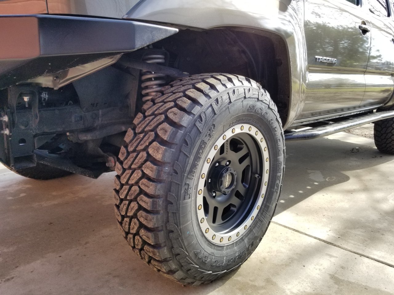

    Nope. Never. And I run a mud tire.

    That's a real nice tire.
