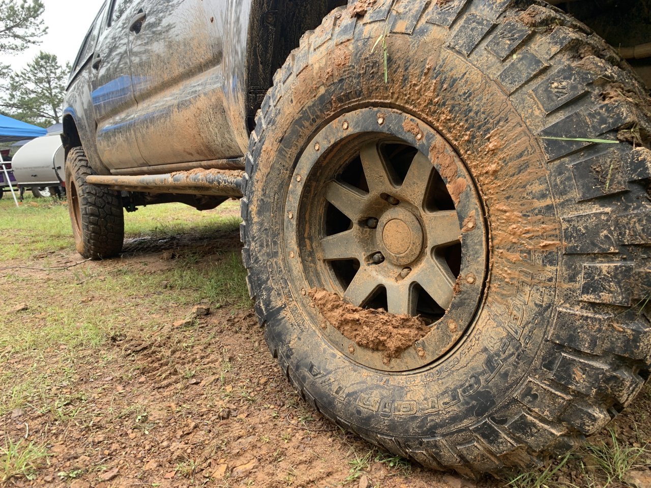

    #269917
    382
    Southern Vermont
    2006 Tacoma Access Cab
    Had a bit of a shimmy at certain speeds for a bit, turned out to be mud in the barrels of the wheels. Now its buttery smooth all the way up to 85-90MPH on my '06

    Sometimes mine shake.
    Then I hose them out and they do not shake.
    My passenger seat, on the other hand, will thoroughly shake a can of paint all the way home.

    '06 and '18 TRD OR 4x4 Access Cab
    My steering wheel shakes when I hit the brakes hard, but I think it's my bald mud tires that are out of balance. Loud and wobbly with the typical wow, wow, wow roar going down the road.
