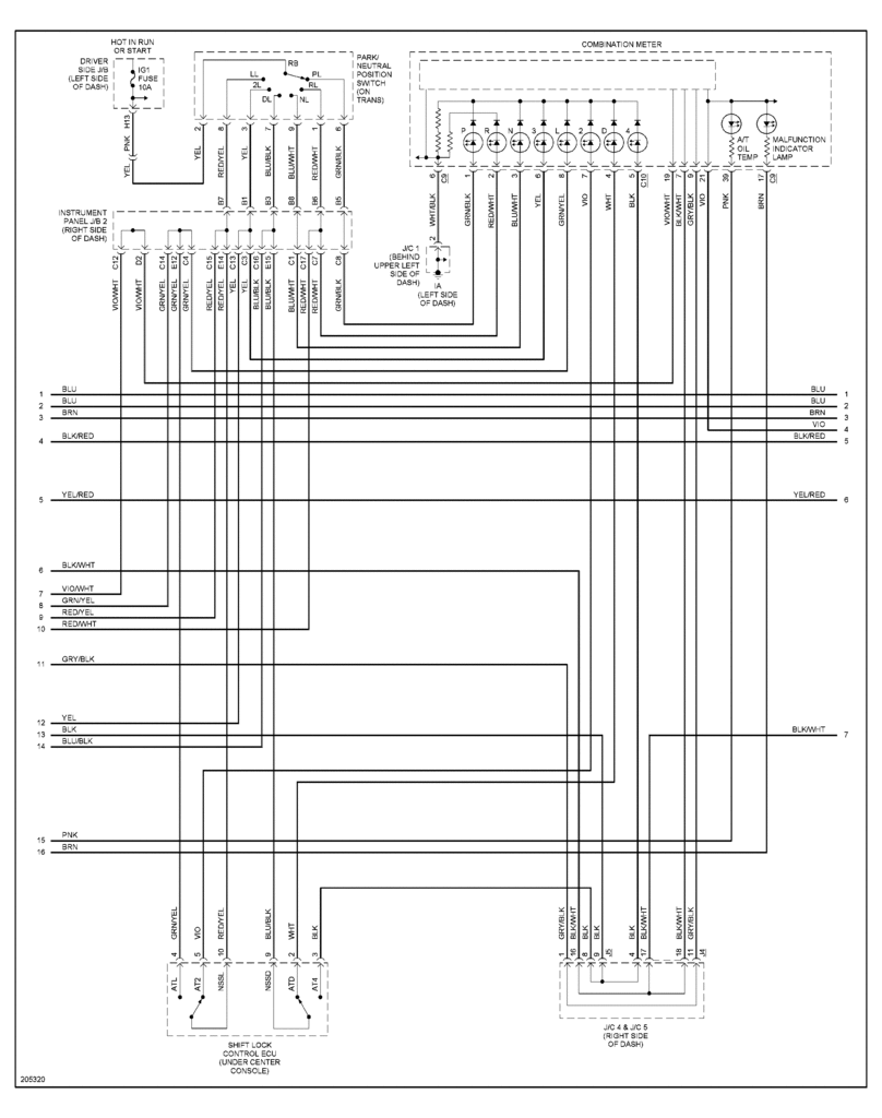

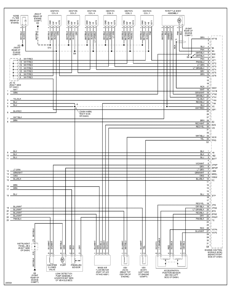

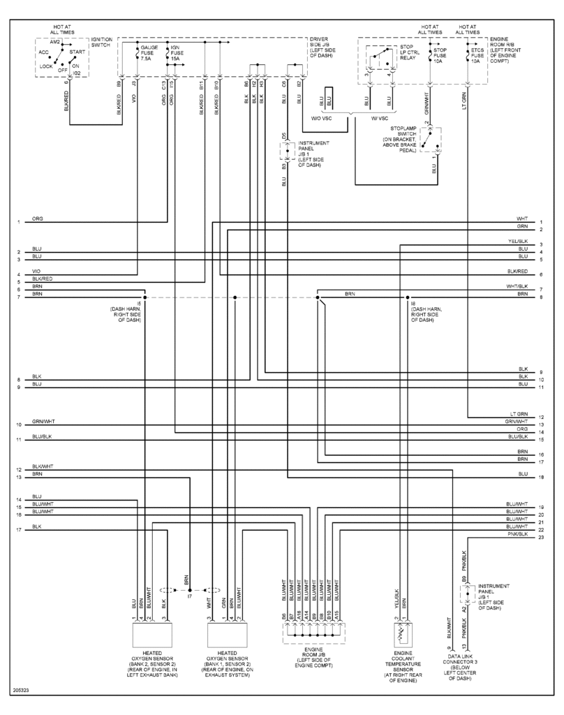

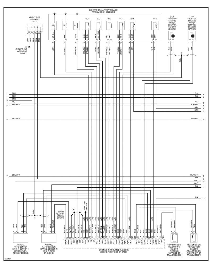

    Have you actually ohm checked all the wires related to the o2 sensor system with a digital multimeter? Just because you inspected the wiring visually does not mean its not messed up somewhere inside that you can't physically see. I'll find a wiring diagram for you and post it up, maybe that can help you diagnose it a little better.
