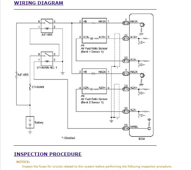

    A/F HTR fuse or relay?
    Loco_Barbon and Skydvrr like this.

    All 4 were showing P032 and P038. They cleared after driving a while and washing the underframe. Still have VSC and Trac lights on. Zero point reset didnt clear it. No codes.
