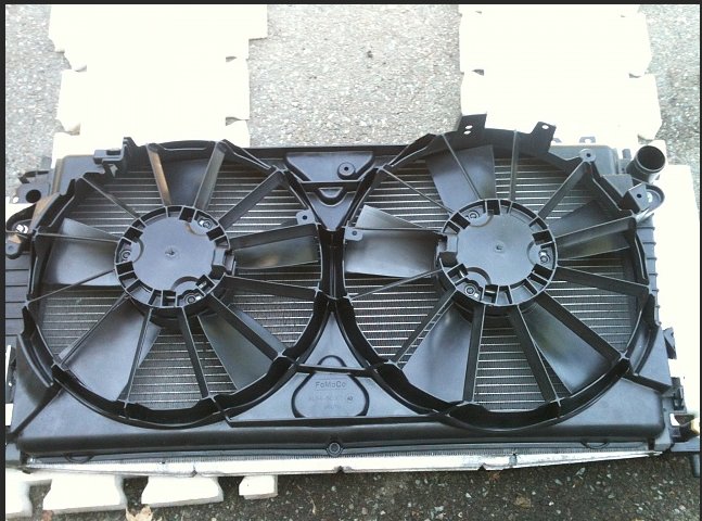

    This is what I have in mind. Below picture is mine from F150, this thing is like a hurricane!
    The controller can be pricy, especially if you want variable speeds plus programable car's velocity cut off point.
    I spent about $600 for the conversion and that was 8 years ago.
