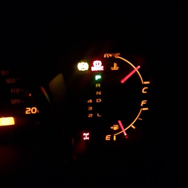

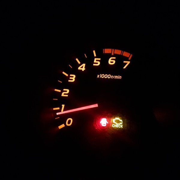

    Pictures? Which lights?

  5. Apr 26, 2016 at 8:46 PM
    blazer69
    blazer69 [OP] Well-Known Member
    Jul 31, 2014
    #135164
    49
    these lights
  6. Apr 26, 2016 at 8:55 PM
    12TRDTacoma
    12TRDTacoma Powered by Ford, GM, VW, and Mercedes
    Aug 20, 2012
    #85133
    16,670
    Rob
    Concordia
    12 TRD Sport DCLB 4x4 Supercharged
    Boosted
    Check your harness plugs behind the drivers side kickpanel. I left one unplugged and my dash lit up like a christmas tree. I would suspect a bad ground next.
