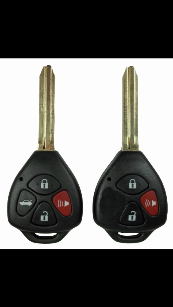

    So after all the hype of the other thread going no where. I started to look further in to the process my self. I found a few information that will be helpfull for those who want an one the all in one key DIY.
    So there are a few options on this set up.
    First you can buy the all in one key from ebay...
    There are 2 different keys; one key has the G stamp and the transponder built in which is what Our tacomas need to work properly to start the truck. But then there is the NONtransponder key, more to explanation about that later
    6F8F5DB7-3FB0-4716-A651-56192B08A83A_zps_3987d520254a01e71da504ec9c45fd9b3acac90d.jpg
    First get the key cut same as your original key at a local hardware store..less than $10ish
    Then
    Here is the info needed to program the fob all-in-one key to work on your truck lock/unlock/panic
    http://www.programyourremote.com/mobile/classified/-toyota-tacoma-listing-7381.aspx
    Ok so that is how to program the key fob
    Now if you bought the all in one key WITH the transponder you need to either
    1) bring the key and truck to dealer to get the chip programmed to truck to be able to start the truck because the transponder
    Or
    2) purchase a Toyota smart key maker. Then you are able to program the key your self with the following information in the link below
    http://www.ecutool.com/Toyota-Smart-Keymaker-OBD_1113.html
    Then with the option if you buy the cheaper all in one key WithOut the transponder. The bypass option.
    http://youtu.be/x4v8l75kP_w
    Or you could just tape the whole damn key in the column near the ignition that way you could use multiple copy keys. Or you can simple place the chip in the all in one key but then that one key and the one original key will only work

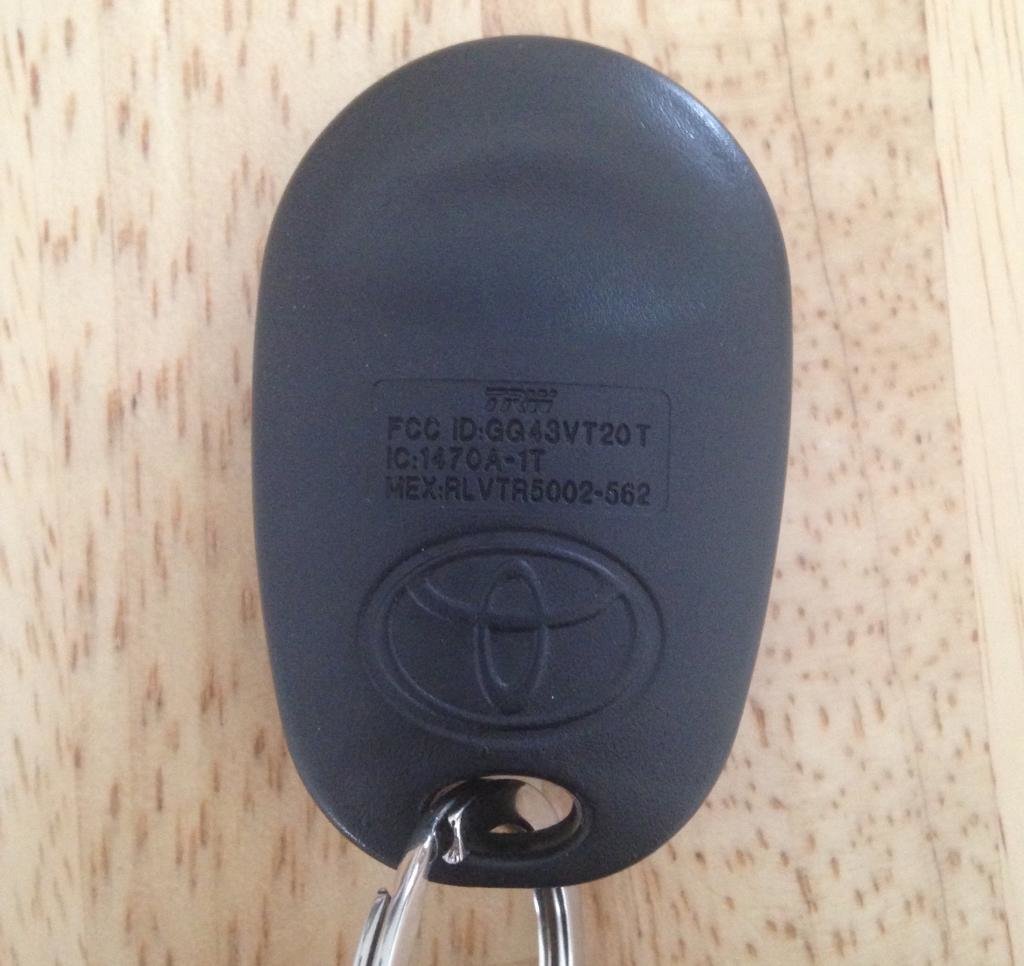

    I understand where your coming from... I simply posted this thread as a HOW TO, to help other understanding how the all in one key works
    Edited sorry didn't read it correctly
    Yes your correct. Thanks for posting again
    Basically the all in one keys must have the internals to be compatible with our truck the FCC number on the back of the fob. So it can be programmed properly. Can't just use a all in one key made for a corolla for a tacoma..

    Neat!
    Silly question.
    Does the anti theft system in our trucks have the capability of understanding a second command channel and does it have an output for same?
    IE the trunk button on the pictured key.
    Reason I ask is I could have some use for it, being able to unlock just my camper shell would be handy. Currently it unlocks with the driver door.
    Sounds silly but if toyota uses the same anti theft system in other vehicles that have a trunk, that capability might be there.
