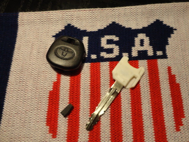

    about a month after purchasing my truck i noticed the spare was bent so i asked my dealer to make me a copy. they hooked it up for free. i think they look to charge $80 or $90 to those who didn't recently spend $30,000 there.
    so if i pick up an all-in-one key i would have to:
    1) get key
    2) get key cut
    3) cut transponder out of bent key
    4) cut/insert transponder into all-in-one key
    5) roll
    es verdad, no?

    The key halves just split apart. The chip is held in with silicone and easy to pry out.

    deconstructed:

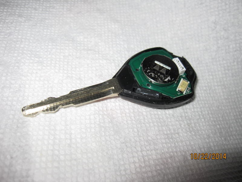

    The all in one I got from neneago has a replaceable battery.

    looks like there's a spot for a transponder too. thanks for posting the pic.
