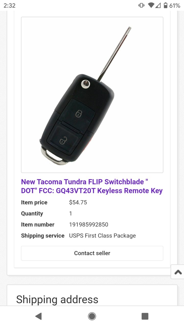

    I have an 07 with the Dot key. I made sure to get the switchblade that had the Dot style blank key attached to it. There is a video on YouTube I used to program the new fob. Once I had that working I took the switchblade and had the blank cut. I also had to cut open my OEM Toyota key and remove the chip and place it into the new switchblade fob. With the chip installed I tested it and it's been working fine for over several months now.

    Video to program fob:
    https://m.youtube.com/watch?v=3qt8iJ8tDD8
    Video to remove chip:
    https://m.youtube.com/watch?v=R610pJxUJAA
    I didn't cut my key open down the center like the video. I cut around the outside and peeled it in half to remove the chip. This way if I want to reuse the OEM key I can put the chip back in and glue the black shell over top.

    I read some of the comments from the video of the FOB programming. Some stated it worked for their 15 so I would think it should work for you as well. Having the key cut shouldn't be an issue but only thing I would be unsure about is the G coded version and it's chip.
    What I did as I was unsure if it would work for my truck was to program the fob first. Once that worked I had the blank cut and once again, tested to make sure it fit and worked. Once all that worked I cut open my OEM key and placed the chip into the switchblade and tested. The fob was $40 so in the event it didn't program or work I was only out $40 and I hadn't sacrificed my Toyota key yet.

    Gotcha...I thought like me, you wanted to convert one of your OEM keys to a flipkey fob. If you want to add an additional key/switchblade then you will need to have the chip in the new key programmed to your truck. Programming the fob to unlock/lock the doors will be same as the video. Or should be.

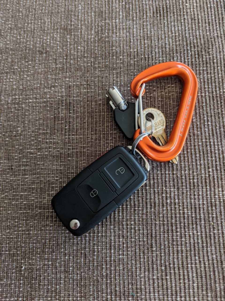

    Bringing this back, I was able to successfully accomplish this. 2009 TRD Sport with factory antitheft, I ordered the pictured key from eBay, didn't need the chipped version as the locksmith I went to cloned one of my master keys and installed the cloned transponder. Been working great since July.

    I'm not sure, I took it to an independent locksmith I found online here in SF - the guys at Ace Hardware and Home Depot were of no help. They provided me a new transponder chip, cut the key, and put it all together. I could have used the transponder the key came with, but they would have had to program it into my truck. Everything working flawlessly!
