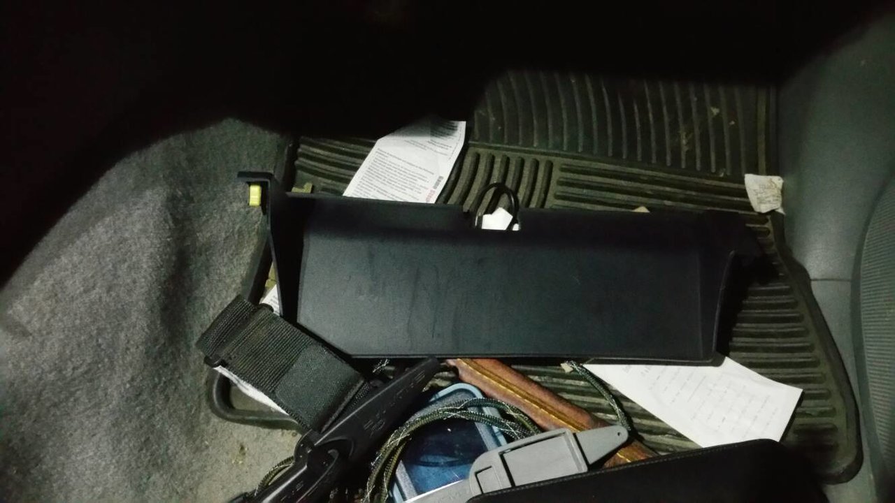

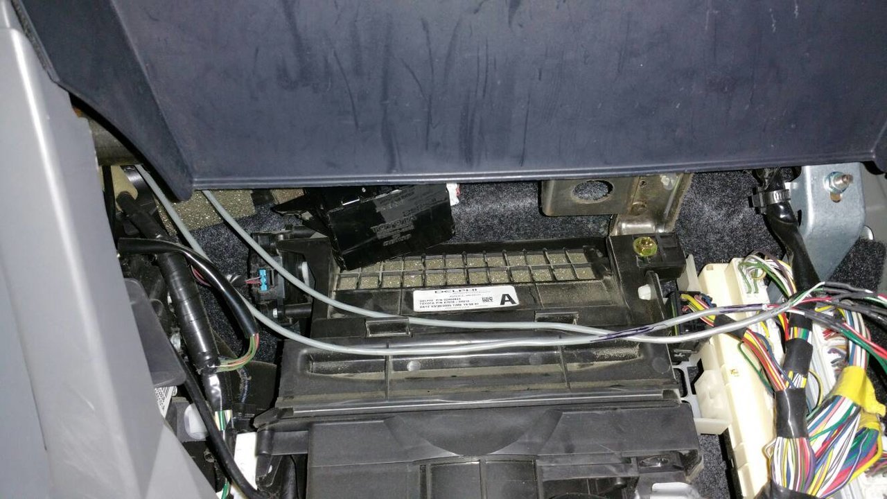

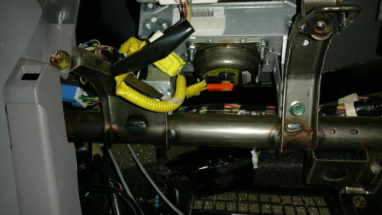

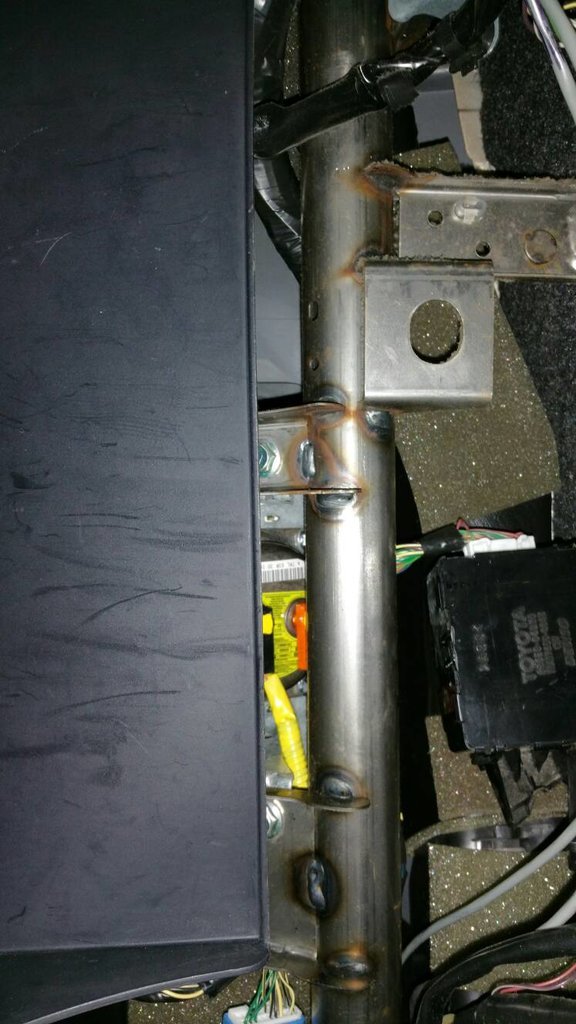

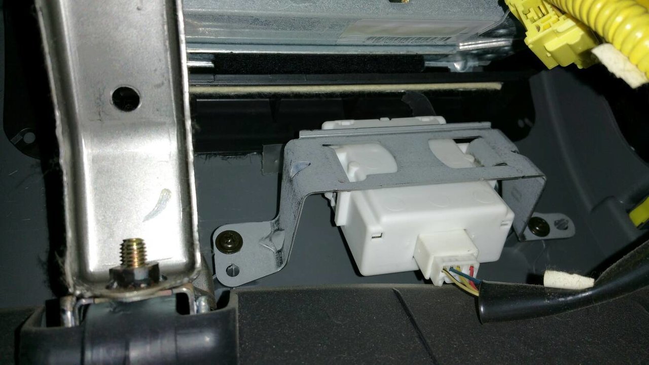

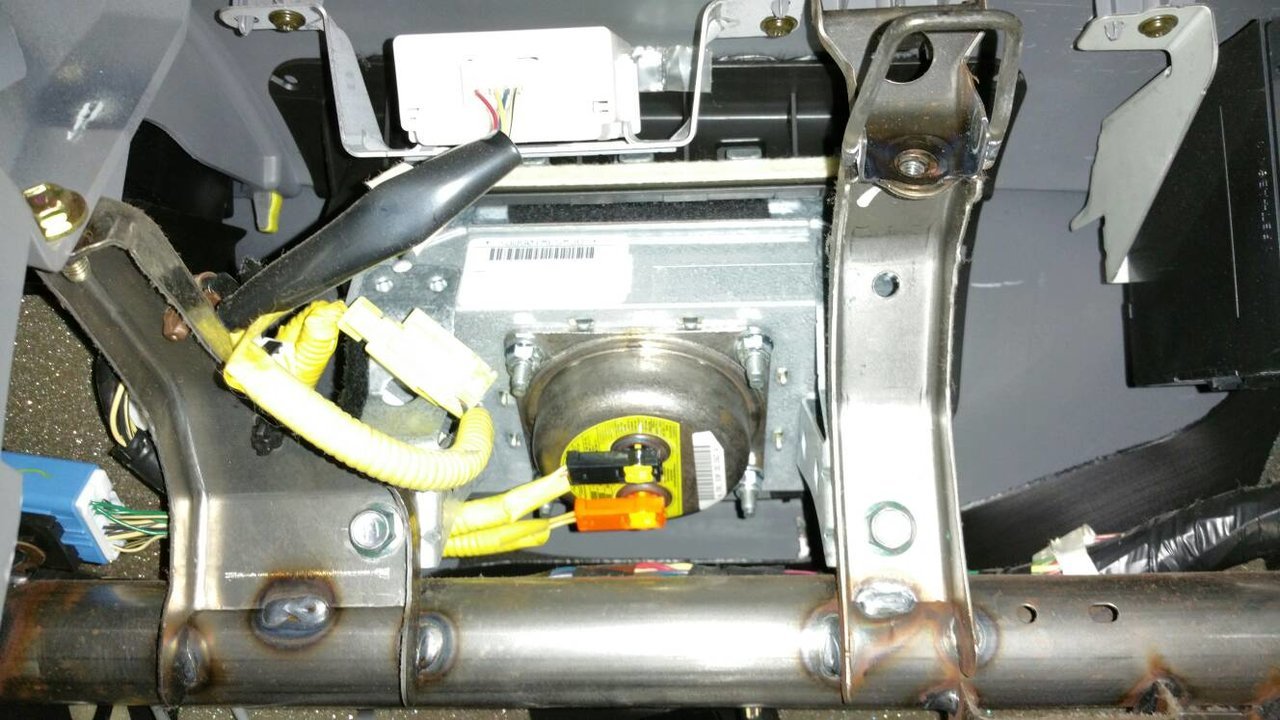

    The White box is directly behind the dash ABOVE the glove box. You have to remove the glove box and the black piece of plastic held on with 1 10mm bolt and 2 clips. Then you can reach up and disconnect the harness.

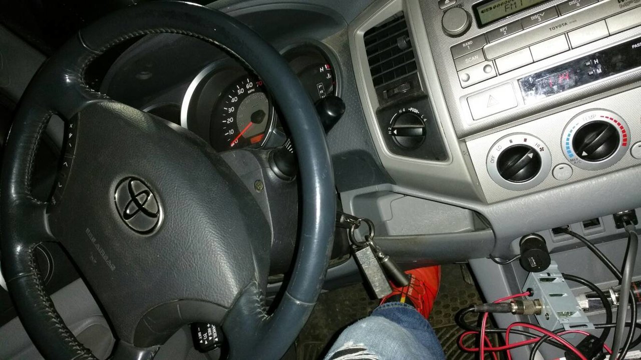

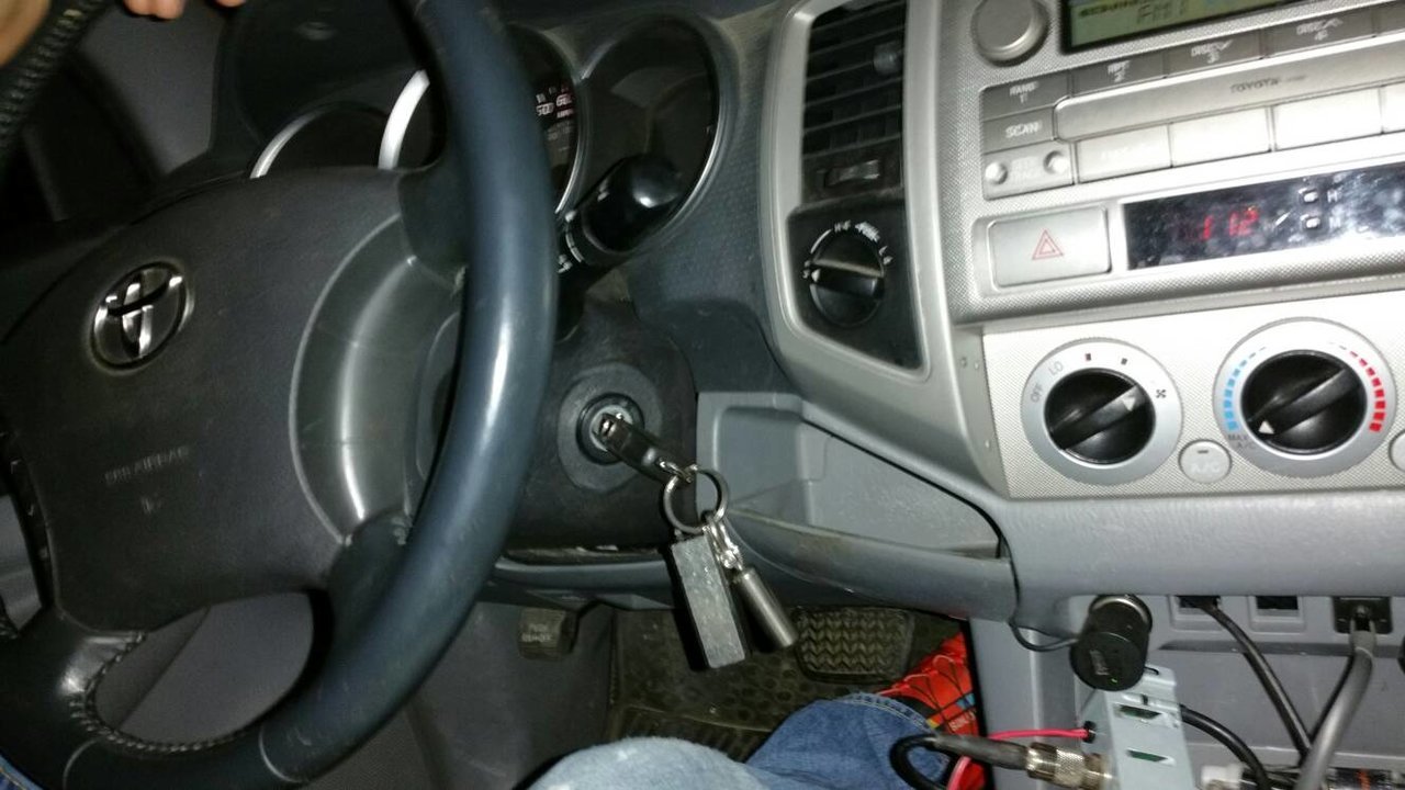

    My issues were and are many. First off I disconnected the box. Started and shut off the truck. Went through the programming with the box detached. No go. Plugged it back in, same process, no go. Back and forth a few times.
    Remembered that my trucks ignition doesn't always 'chime' when I put the key in. Basically the switch or pin in there is heavily worn or failing. Tried it again making sure that I heard the chime every time I put the key in by holding it in a specific position. Still no dice. So I manually cycled the locks. No joy. Pulled up my Torque App, cleared all ECU codes. Did the process all over again. Yeah. All the remotes work now.
    I mentioned before, the truck has been forgetting remotes at random. No clue on that issue. But all the fobs I have are working now.
    My remote that i was daily driving had issues before all this. LOCK never worked after the dealer had the truck for some service a few years ago. Decided to re- solder all the connections on the whole board. Guess what, lock works now.
    Thank you OP. I really appreciate this. Also, when the new fobs are in, I'll grab one of the new flips and an all in one.

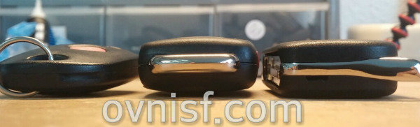

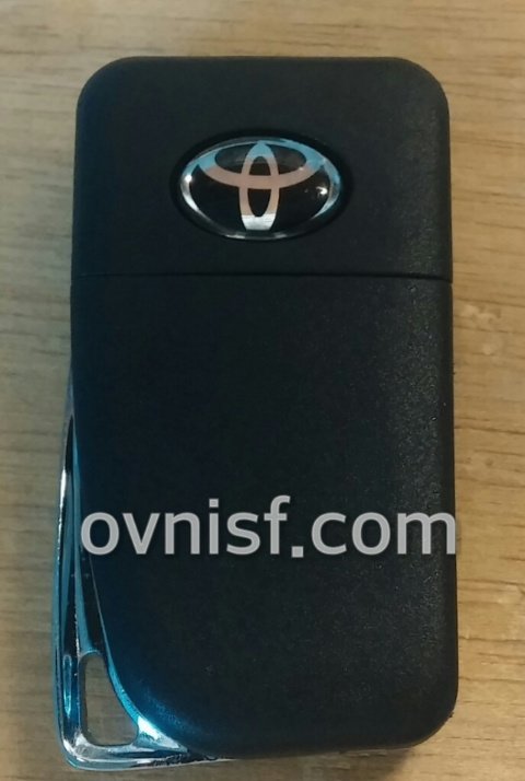

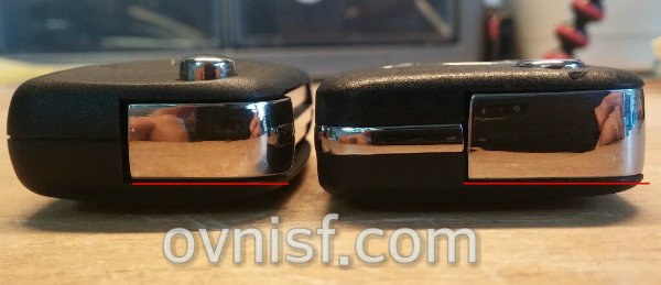

    got the new flip key in today.

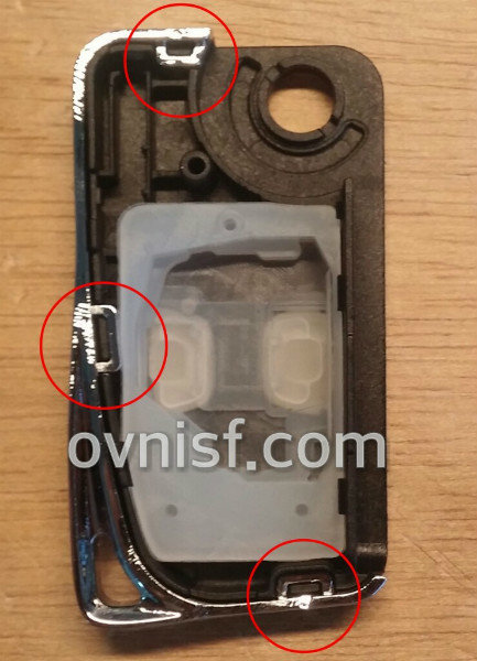

    Information below is from a visual test...no real world test yet. Sarge will get first key to test in extreme situations. If the key can survive with him...I will stock it. I will also test one myself in the mean time.
    1)Texture feels great and quality LOOKS amazing. Snaps up well with no open gaps.
    2) The key ring is amazing as it wraps almost all around key. Snaps into three places inside shell. I don't think we need to worry about key ring falling apart.
    3) Pivot point expands half way across key. Strongest pivot point I have ever felt.
    4) Thinner than VW Style
    Cons..
    Inside is not 100% tailored for my circuit board. I had to do a little shaving. Will report to manufacturer about issue.
    Im still trying to work out proper tension for spring. Sarge might have to tighetn it up a bit..

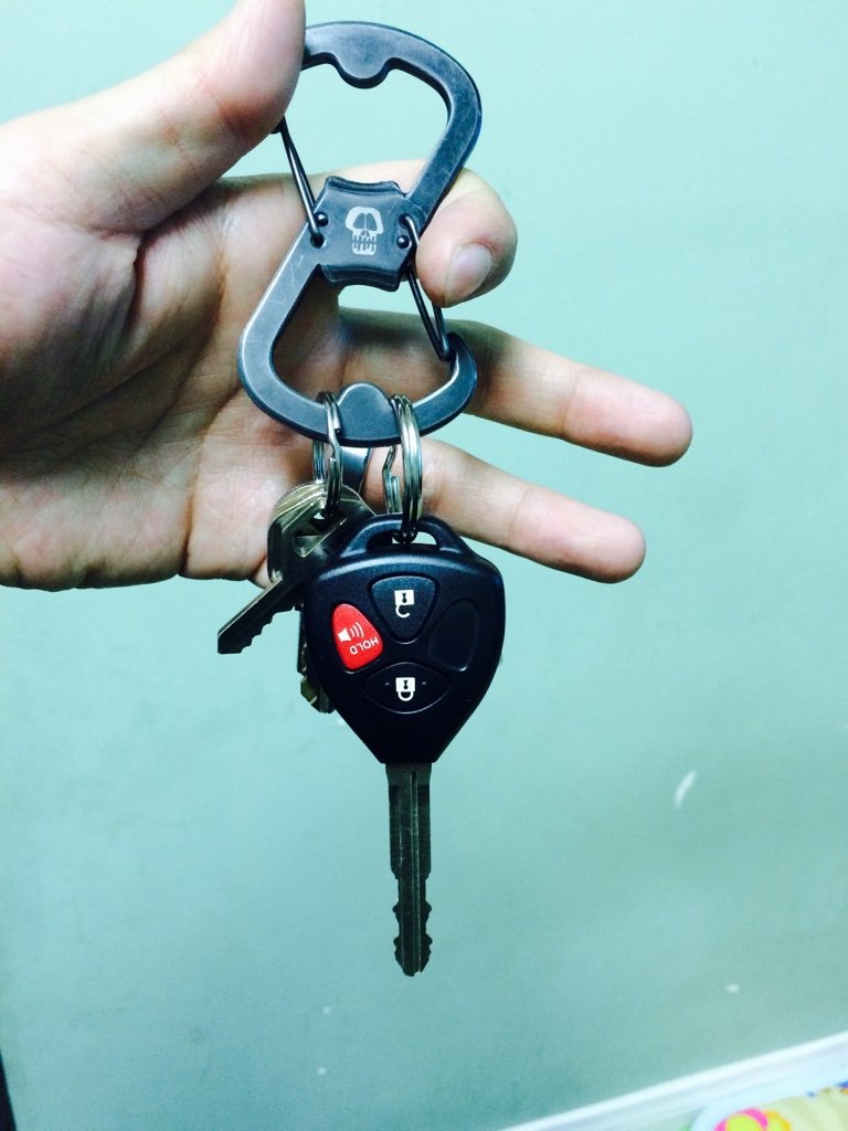

    Went on a journey to finally get my keys done. The locksmith I went to gave me a bunch of back talk about how the key isn't going to work without a special computer and only professionals can register a key and wouldn't cut my key until I told him I already got Techstream and that all he had to do was cut the damn key. $3 later and an hour trying to figure it out, my new key works. Works like a dream and love that I got one less thing to hang off my keys. Thanks Neneago for making these!
