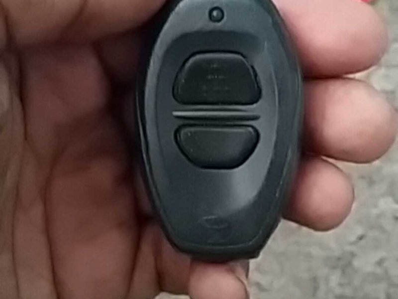

    What year is it? I do have something for the 2000+ model.

    Go to my website. I have it there. Look at the remote key section for the
    BAB237131-056
    If you want the flip, send me a message on my site.
