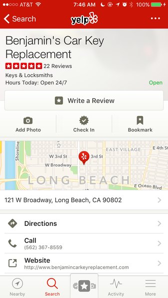

    Any recommendations for a locksmith in the Long Beach area that can cut and program the flip key ?

    This guy looks pretty legit:

    Thanks , I also seen him in Yelp , I'm just waiting for my flip key to get here . I had to order one from oversea hopefully they work the same as the ones bought here.
