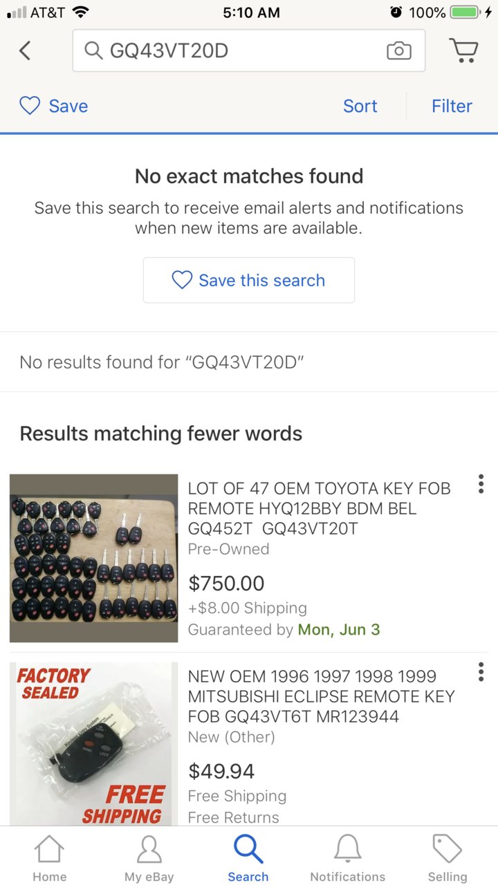

    These are still available all over eBay. Just ordered one myself. Search for GQ43VT20D DOT. Pulls up at least 10 listings.

    I'd try this one, best price for the G chip and it's out of Taiwan where a lot of OEM parts are made (usually much better quality than China)
    https://www.ebay.com/itm/361652068733

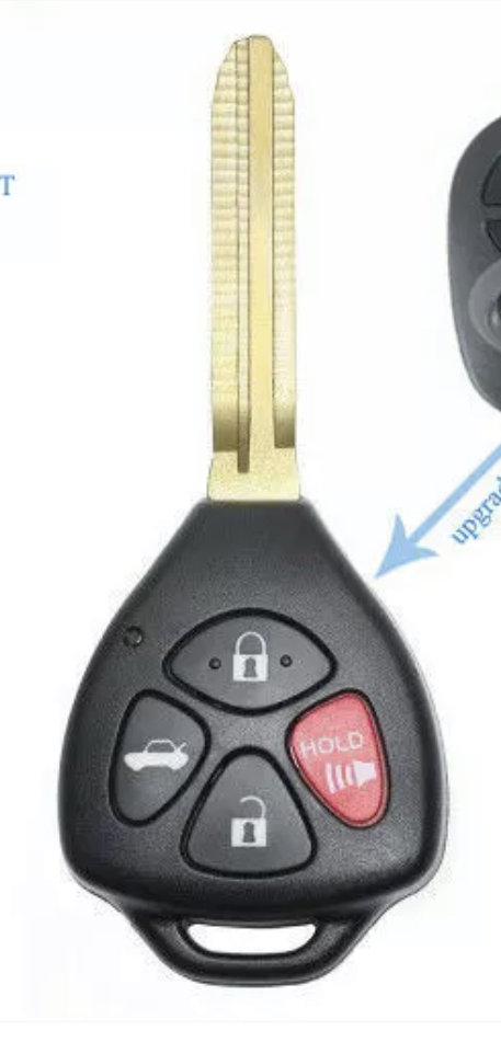

    When y’all say all in one key, are you talking about the key with buttons on it or the flip key?
    I’m really trying to find an all in one key with buttons on it that’ll work instead of using a remote + key or flip key.

    Yes there were two options, a “remote key” (pic below) and the flip key
