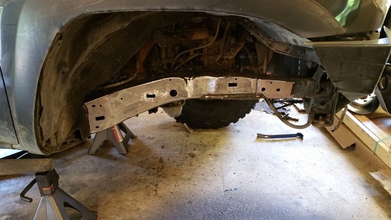

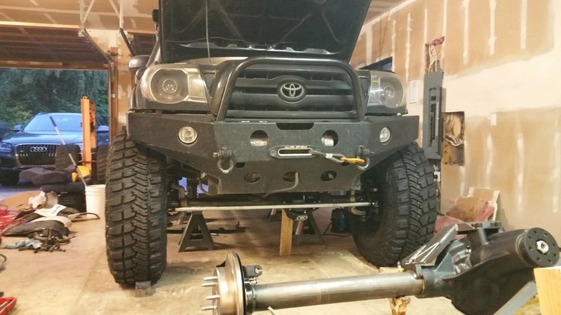

    I've been a little busy so I haven't done too much but I did get everything cut off the front. Put the axle in to just see how things look like and take some measurements.

    Is the axle about center in this photo? If so, what's the WMS-WMS width of the axles you have and any info on the size/backspace of the wheels you are running? Thanks! And keep up the good work!

    It needs to be moved passenger half an inch to be centered. WMS is 70", wheels are 17x8.5 4.5BS. Tires are 40x13.5 MTRs. I tried to keep it as narrow as possible without rubbing anything and from all of the measurements this is what I came up with. I should barely be able to clear the frame at full stuff and lock.
