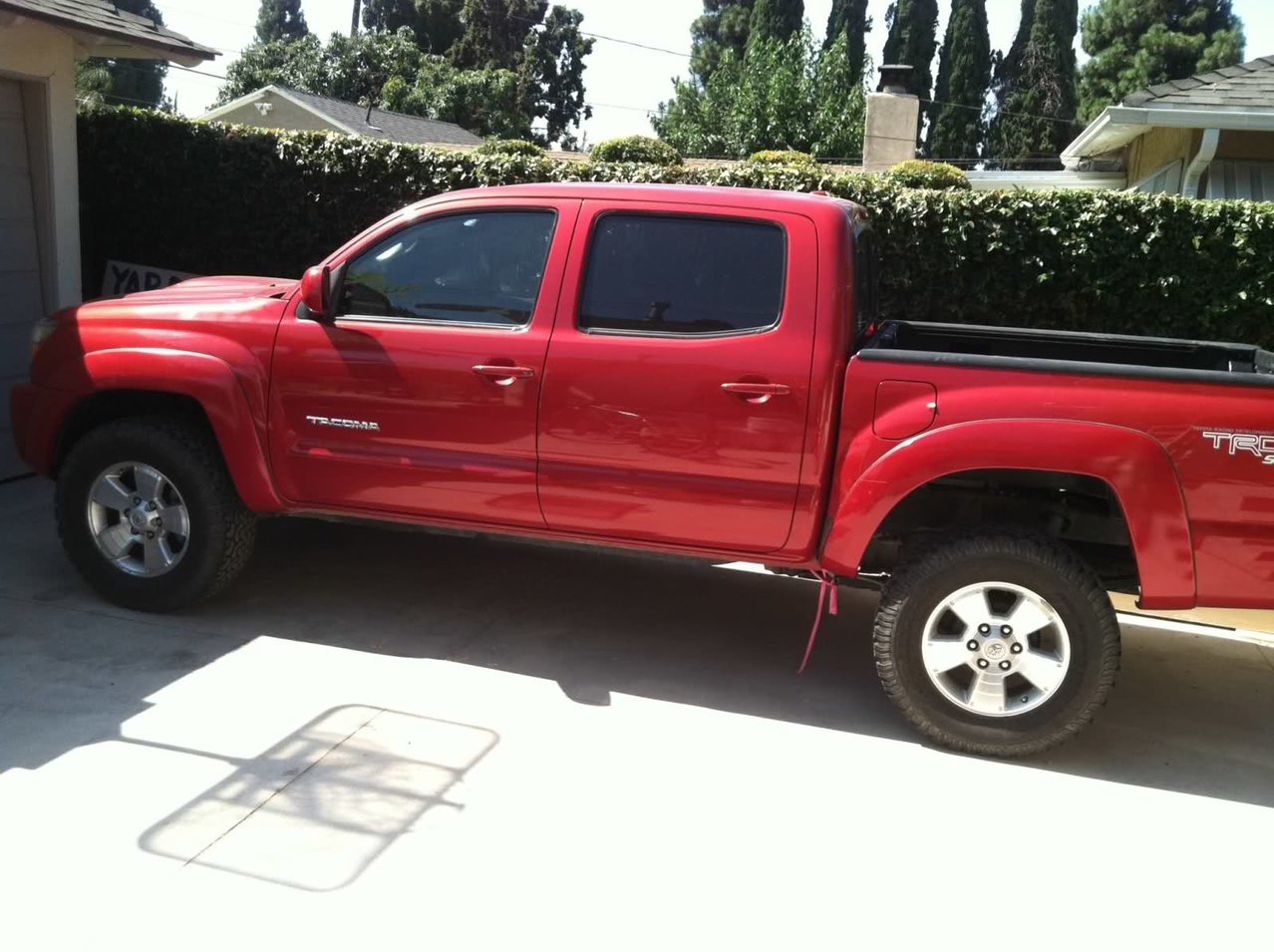

    here is my truck with the front still stock and my 3 inch all pro leaf pack in the rear.

    looks real good. i need to pick up a leaf pack soon! when you getting the spindles on?
