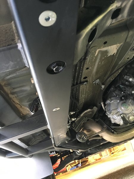

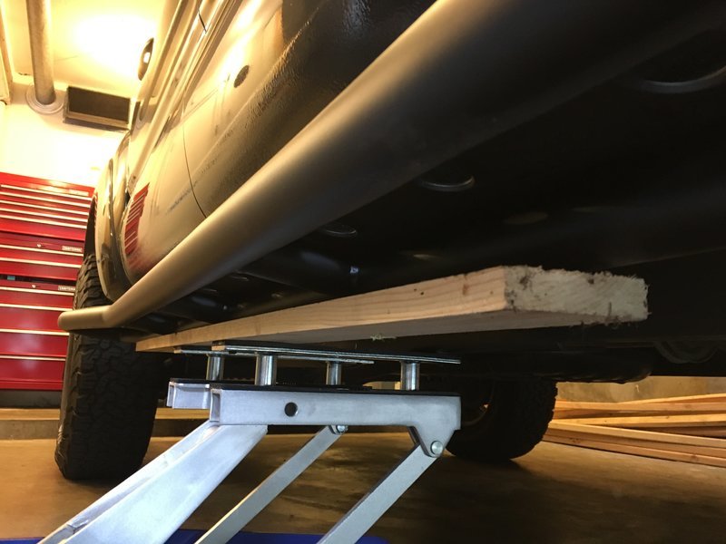

    Weight was a surprisingly negligible effect on height or performance. I am running 650lb coils in the front and progressive AAL rear. The added weight is very well distributed between all 4 corners. Drilling isn’t hard, just time consuming and a bit tiring. The frame is thick, though I do have some new bad ass drills that should make quicker work of it than my old one. I also still have the motorcycle lift to make install a breeze.
    Install is relatively straight forward, several mounts bolt through existing holes in the frame horizontally. Bolt it up into rough place, press into place with the jack, mark the vertical drill holes, then drill away.

    When drilling into the bottom of the frame use a bootle jack under the drill,no big effort then. Doesn't help the OP now but a tip for someone in the future.
