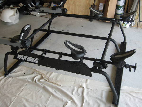

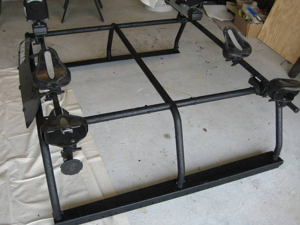

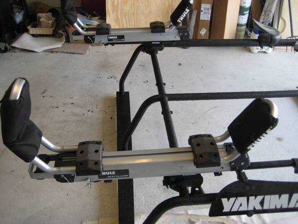

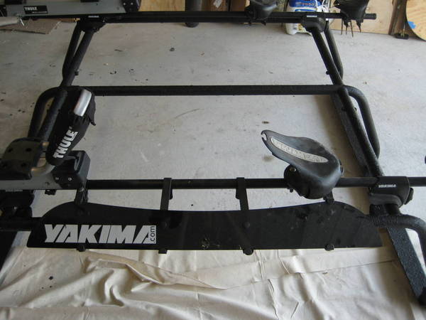

    Just finished with the rack. I have my Yakima towers attached to it and the Thule Hulavators on top of it. I was somewhat worried that I wasn't going to be able to mount my rack and kayaks to it, but it has turned out to be a very stable and strong setup.

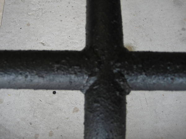

    In the end I had to completely sand down the powder coating and I rolled the Duplicolor Bed Armor on it. I'm pretty happy with the Bed Armor and I think it'll hold up very well. If you apply it thinly, the stuff will just peal off with a fingernail; you have to really thicken it up and it's a lot stronger. I took to it with a hammer to get a couple of pieces together and it held up suprisingly well under repeated blows.
    Just wanted to post these pics in case there would be guys wondering how they were going to mount their racks.
