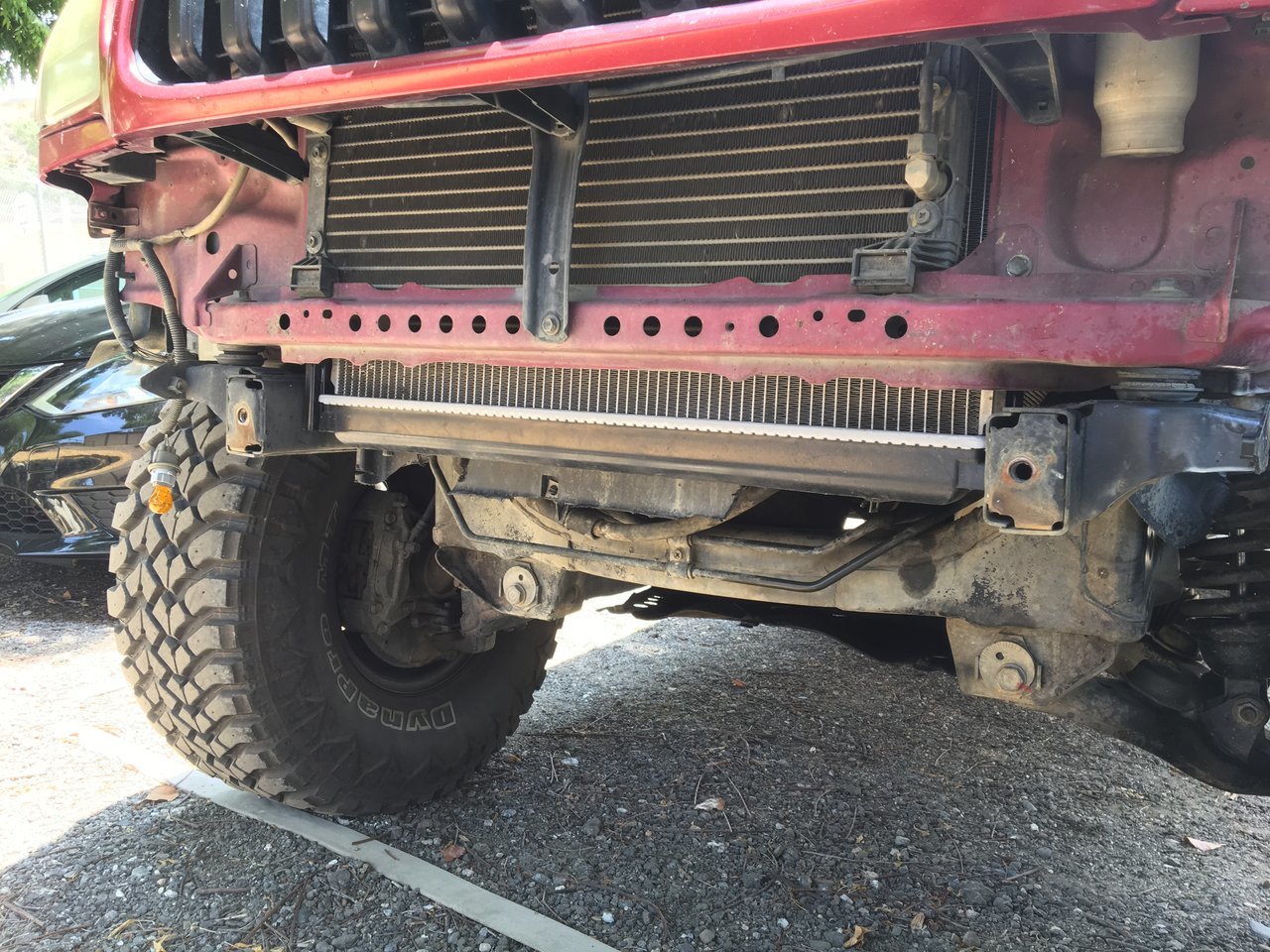

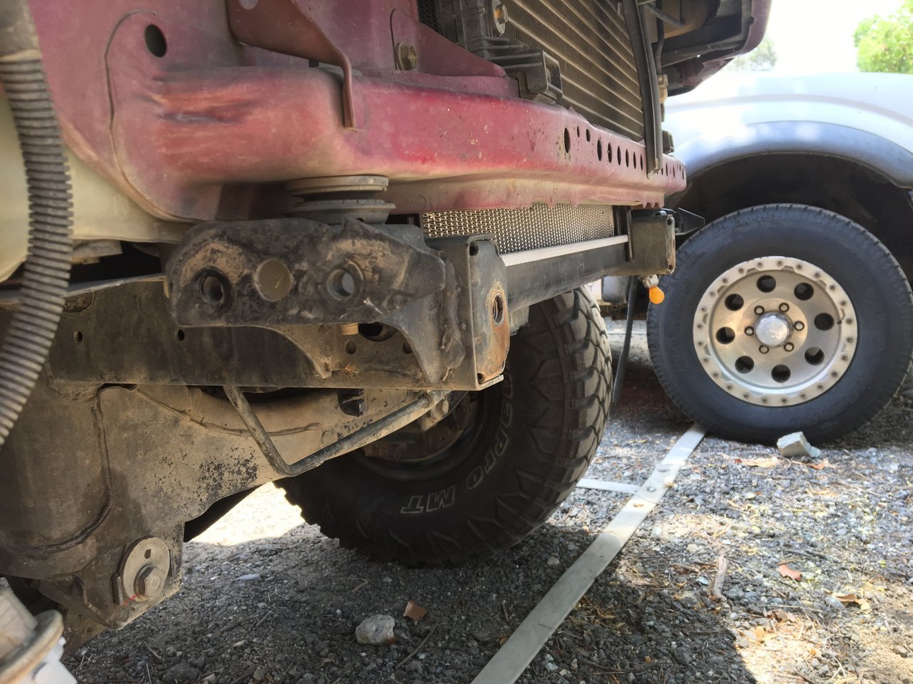

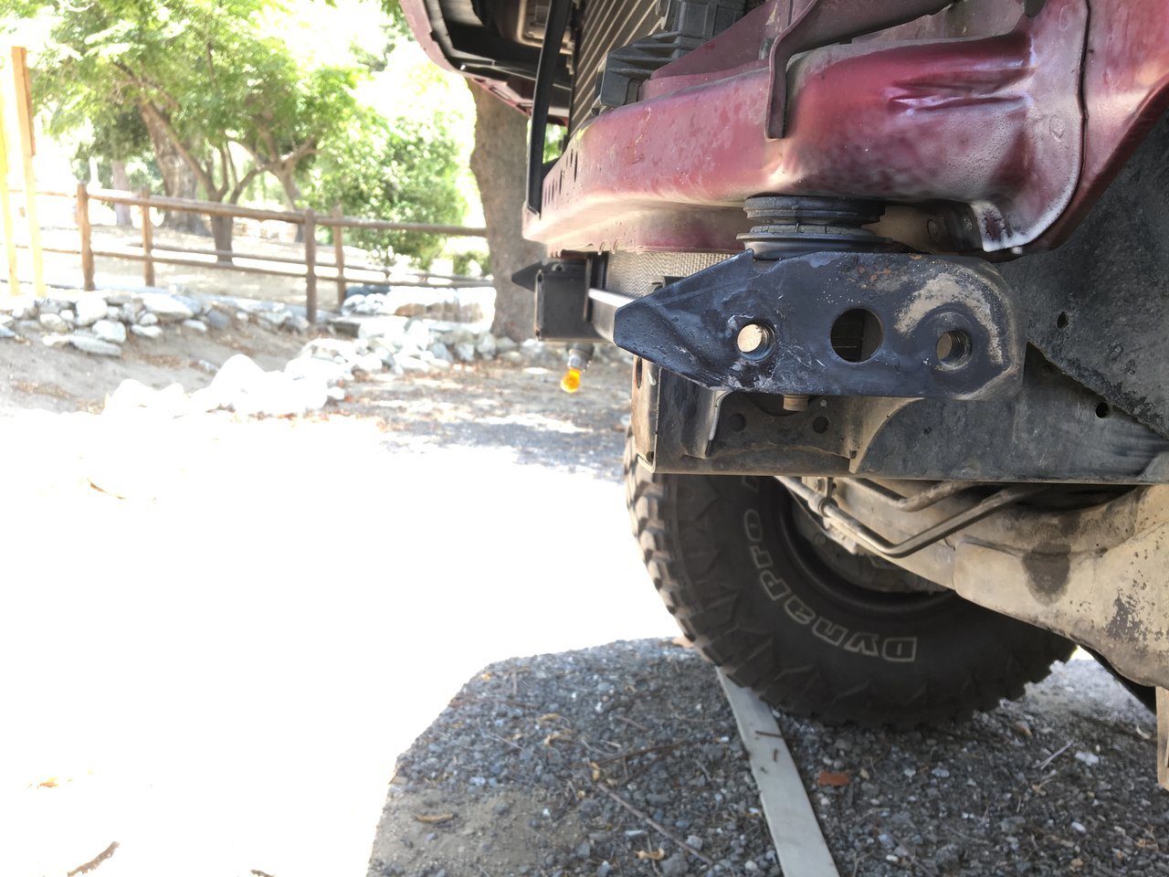

    Hey guys, picked up a All-pro Baja bumper yesterday. I have an 04 Ext cab. I unbolted the stock bumper last night and went to try and fit the new bumper over the mount spots where the crush cans would be basically I think. And I ran into some problems with tight fitment. And what seems to be extra metal that needs to be cut in order to fit the bumper mounts up. Any tips from guys who have mounted this bumper in the past would be awesome ! It seems like I have to cut that point in the metal right after the nut bolt in point in the 3rd pic. But seems odd. Thanks guys!IMG_2096.jpgIMG_2099.jpg IMG_2100.jpgIMG_2103.jpg

    you gotta cut the tips off of those horns.
    otherwise, it should be a tight but manageable fit. i was able to get mine on by myself with some patience.
    did you get new bolts for mounting? with the passenger side under frame bolts being longer to accept the tow hook, you may need to put the hook back on until you can get shorter bolts.

    Found out I had to cut the tips going to install tonight ! Didn't know I needed different bolts as it said use stock hardware.... but might use washers if need be I think I read that somewhere . Thanks for the input guys !

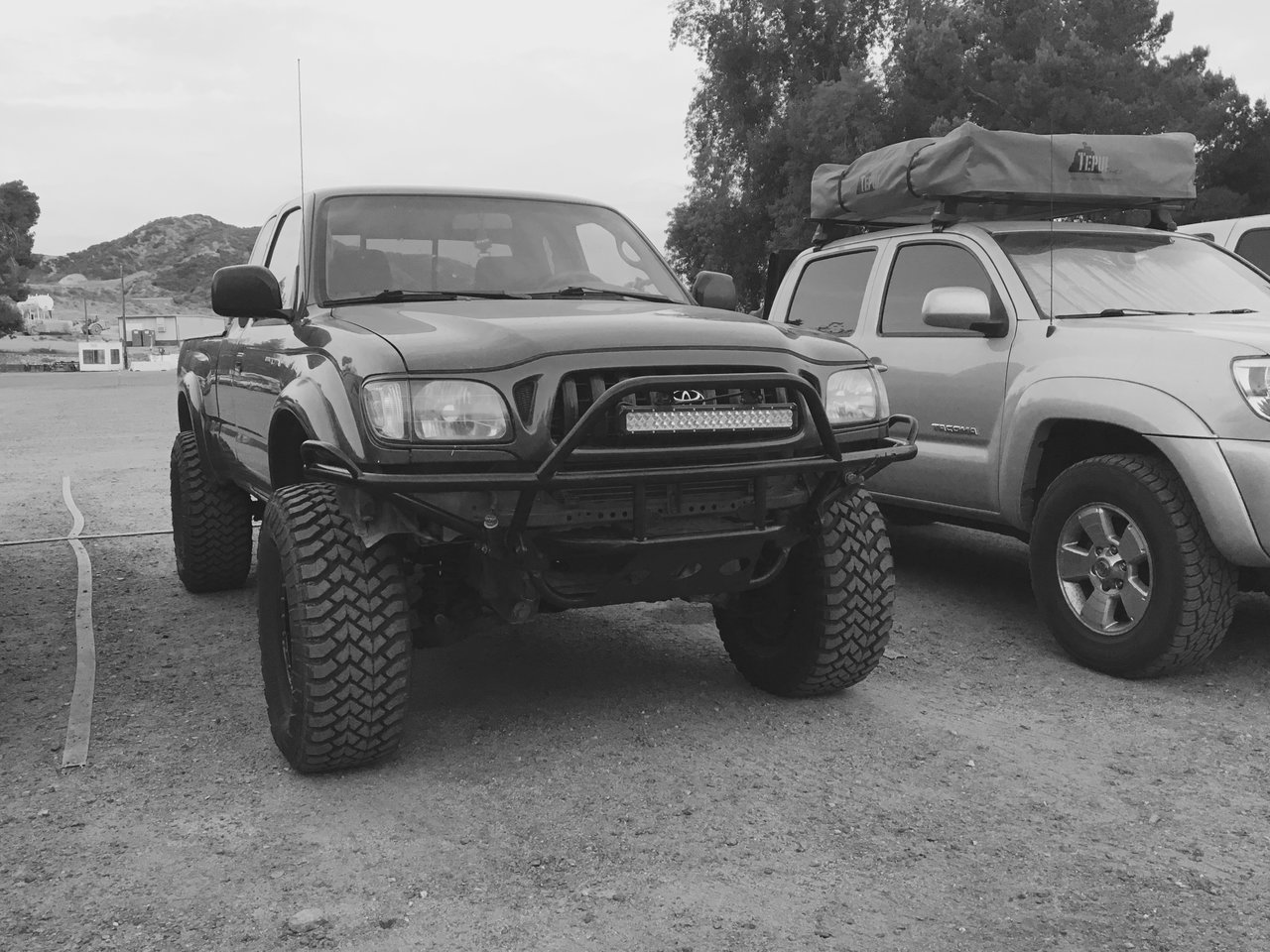

    IMG_2119.jpg Got her on boys... and I absolutely LOVE it
    Shout out to @MstrYota for hooking it up
