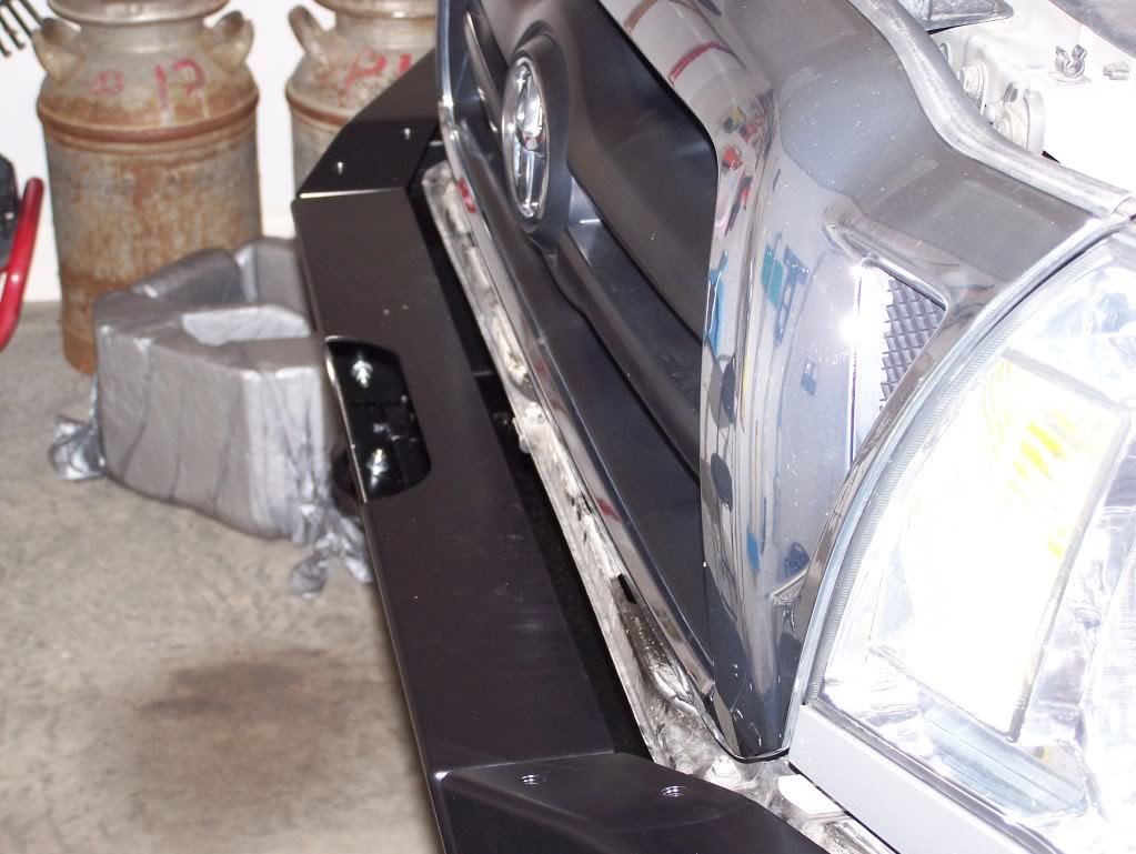

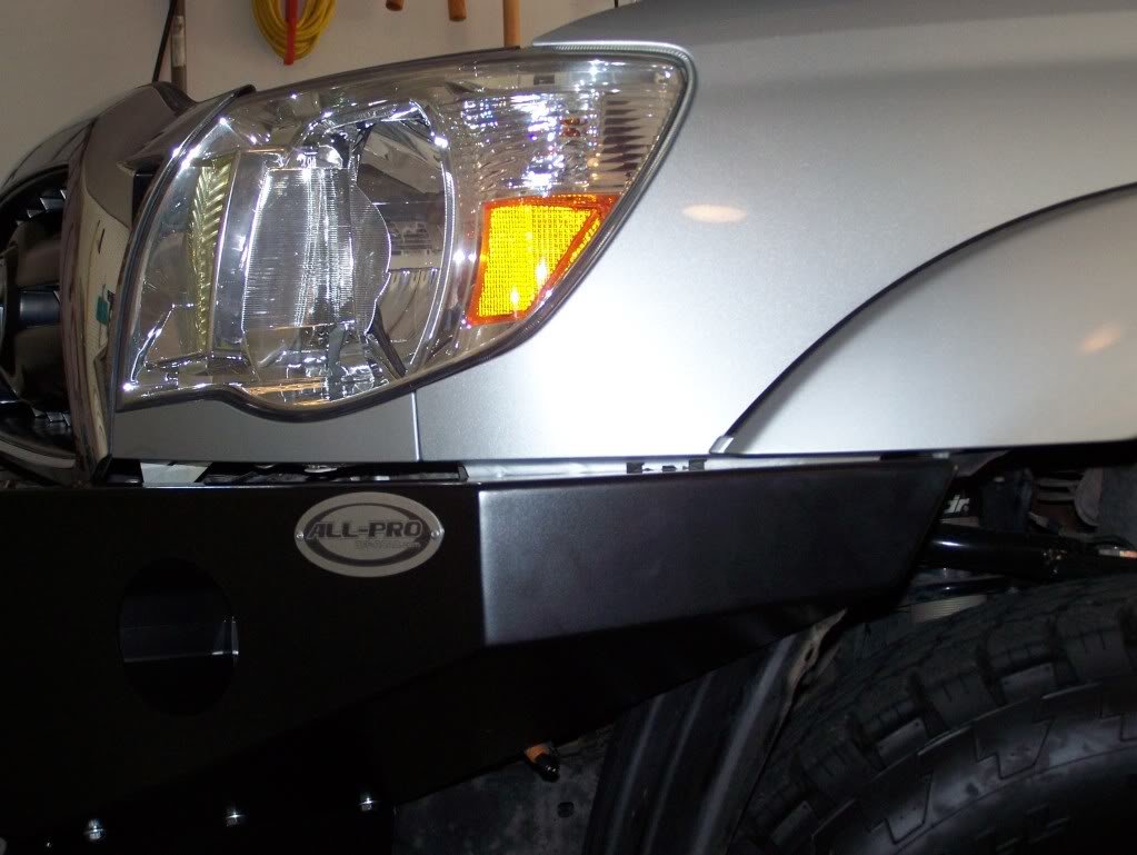

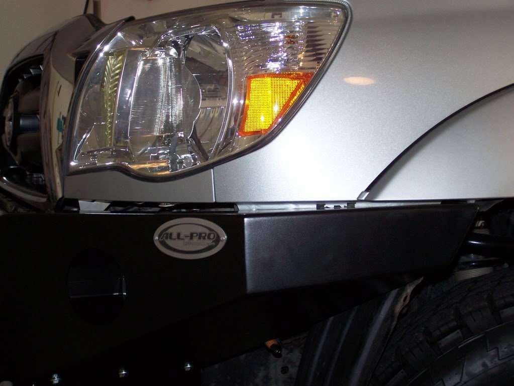

    OK, I've read dozens of posts about the sides of the AP bumper initially coming close to fenders and people use washers, but where? Is it under the bottom of the 6 posts that the aluminum bumper attached? Need a quick reply if possible.
    I'm sending photos to AP now, but they said this is not normal... :confused:

    No worries... Between Sarah, Pepe and John we (reads I) got it all figured out. I'll start a thread with pics later. ALL PRO SUPPORT ROCKS! :cool:

    You should be OK without cutting. I have a decent bit of clearance and all of my issues were my fault. I didn't see a small package of hardware in the bumper kit and tried reusing the 17mm heads to screw the bottom of the bumper onto the truck... All Pro provides 19mm heads (same thread pitch as factory) just longer, which was causing my issues.
