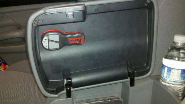

  15. Feb 23, 2012 at 6:33 PM
    JasoTaco
    JasoTaco Well-Known Member
    Jan 25, 2010
    #30057
    2,002
    Jason
    Salt Lake City, Utah
    09 Tacoma TRD Off Road
    ToyTec Ultimate 3" Lift -TSB Rear springs - TRD Cold Air Intake - TRD Skid Plate - Total Chaos Upper Control Arms - 2 Hella Rallye 4000 lights (130W Bulbs) - Clear Bra - Under Coat - Bed extener - Toyota Bed Mat - Weathertech floor mats - Tailgate hose clamp & washer mod - PIAA Fog Lights - ScanGauge II - Beefed Sliders - Differential Breather Mod - Heated Seats - All-Pro Bumper - Warn M8000 Winch with wireless controls - Boztec Diff Skid - ATO skids
    As promised here are some pics. Of course you don't have to run the wireless setup with how I mounted my solenoid.
    I used all factory threaded holes on the body of the truck, just picked up some bolts from Lowes. You do have to slightly modify the back of the solenoid box so it will fit flush against the truck.
    I have my remote mounted with some Velcro under my center console. It’s out of the way and there when I need it.
