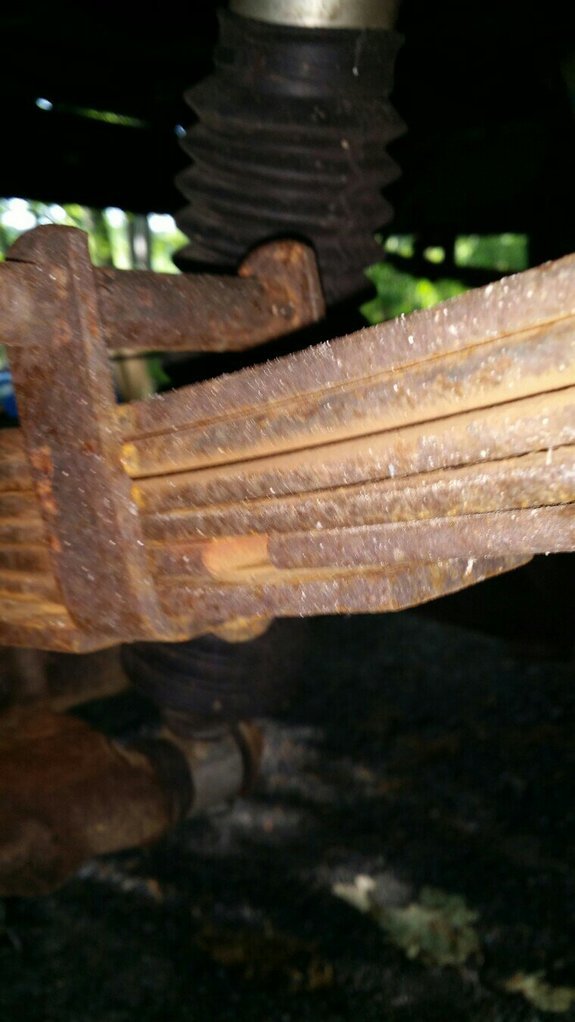

    Standards rustacular and broken. Just over a year old. aze9azar_c0927dbf236440a123814ee2e273f4ee0e8b1b2f.jpg
