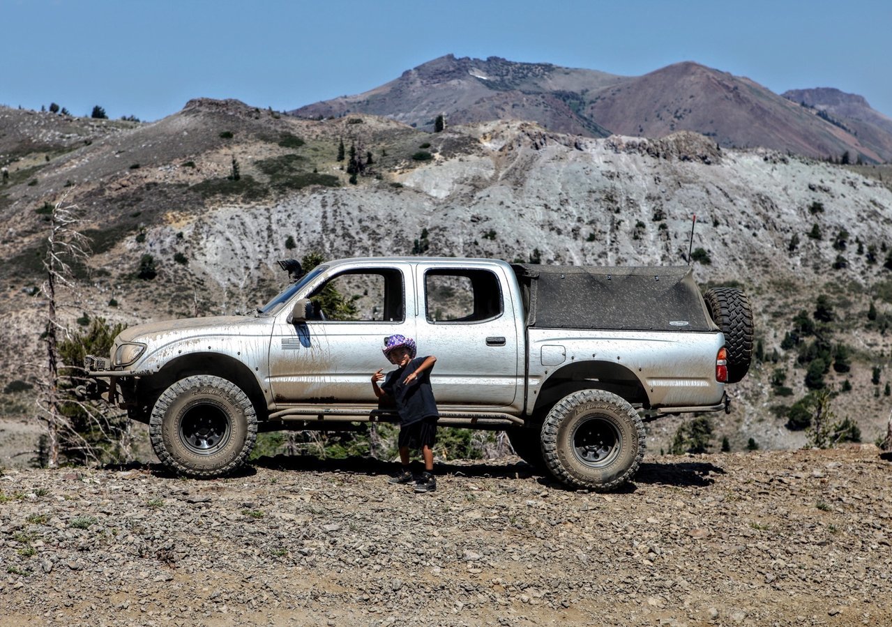

    Love mine. Rides great even unloaded. Here she is empty
    FirstGen Jer and geoyota760 like this.

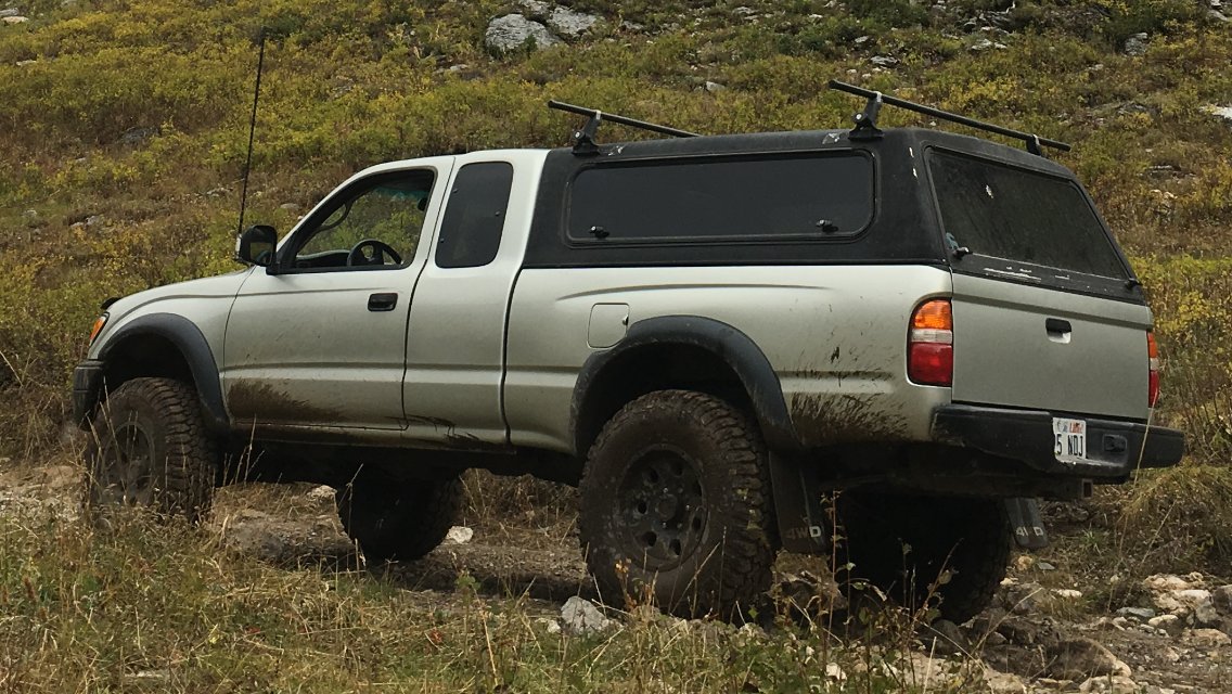

    Expo’s with billies. I’m very happy with the expos, they handle extra weight great, but are still pretty flexy unloaded. Get yourself the ubolt flip kit while you’re at it. I’m not exactly sure about the shock length, as I bought the kit with them included1A9EAD4B-83C4-46B0-BA4E-09E90CBD75A2.jpg
    yota_aidan[OP] and geoyota760 like this.

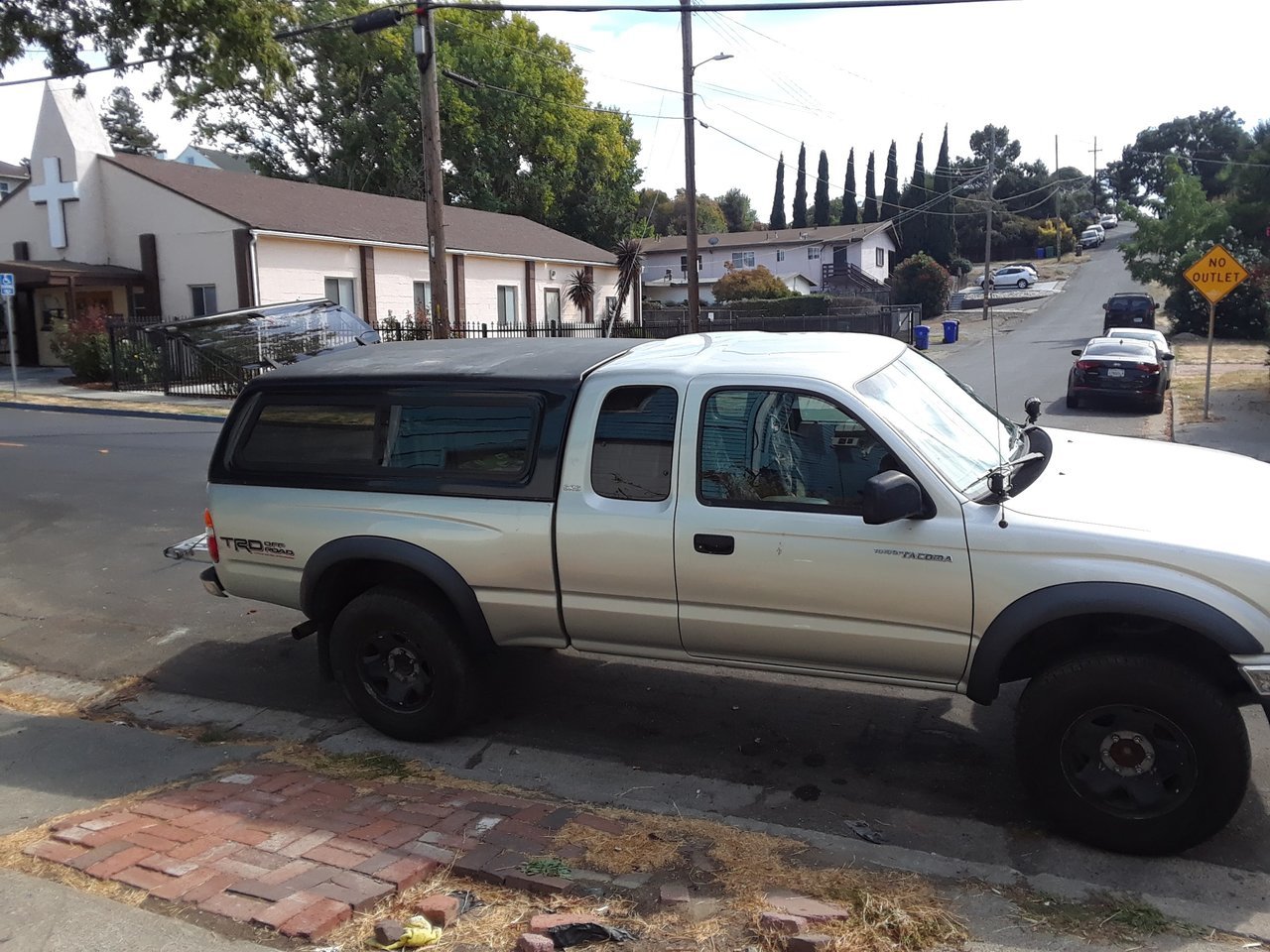

    Almost twins...lol
