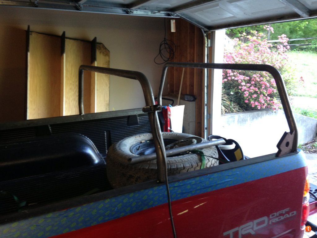

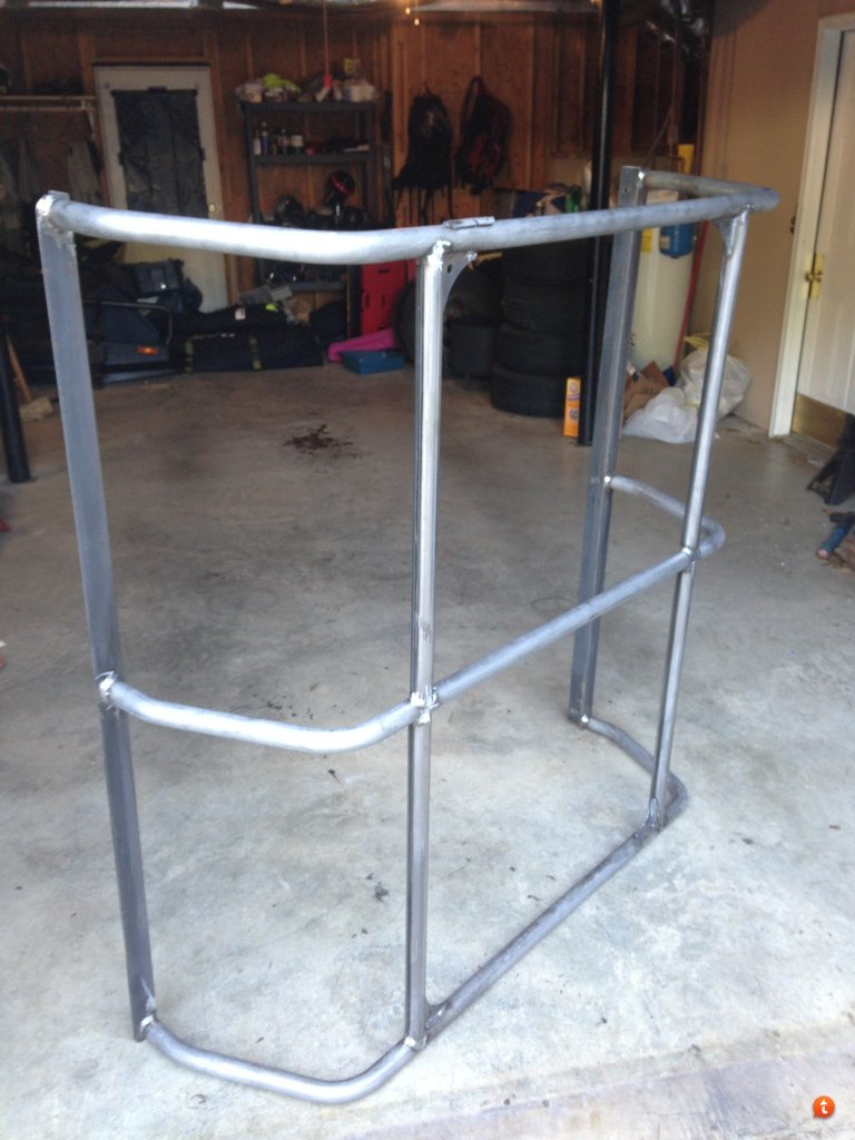

    All welded up and ready for primer. Please ignore all of the grinding marks!
    Hope to have it finished and on the truck this weekend.
    Thanks for the GB All Pro!

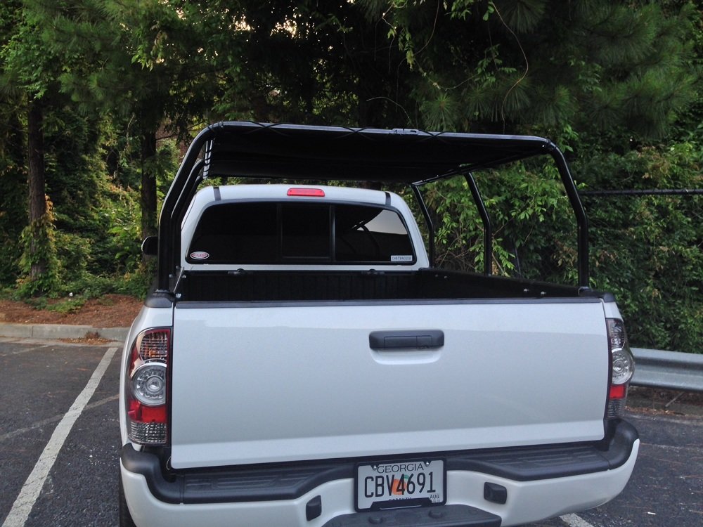

    Fitted canvas top ftw

    Looks great! What did you use? Tell us more.

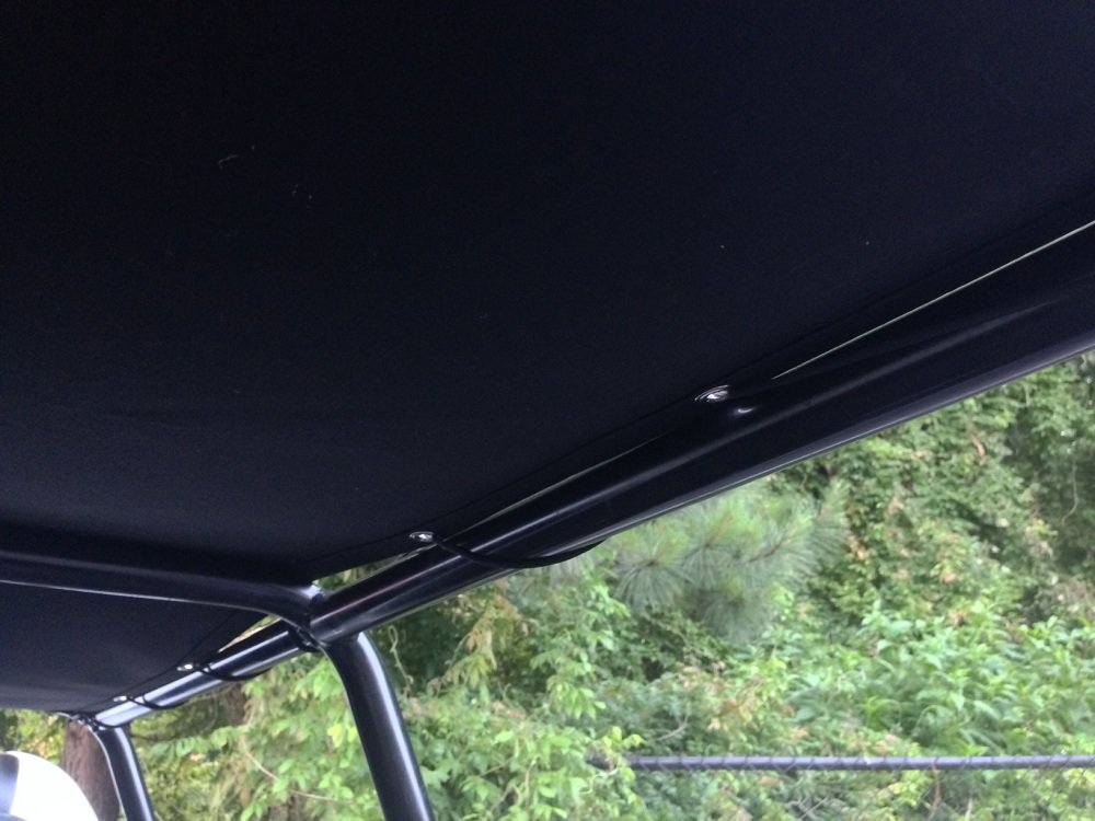

    UV-stable awning material, grommets, and all edges are folded and sewn. Used 160lb paracord and zip ties (to keep it classy) to secure it. Then used pro-grade velcro on the center bar so it doesn't "bounce" at speed.
