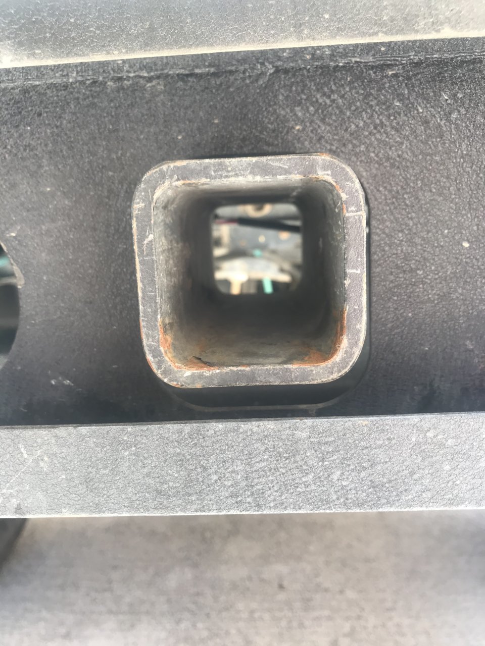

    I have a all pro hidden hitch and almost NOTHING fits inside of it! I only have one trailer hitch mount that fits in it. Anyone else have an issue like this?

    I don’t have any problems with mine. Are the problem ones low weight rating with thinner wall tubing that has sharper corners?

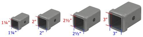

    Different class types
    Your post is a bit vague so unsure if you meant the same class type doesn't fit, or if you're unfamiliar with the different class types.

    Different class types refer to different tongue weight/towing capabilities.
    A sleeve is used when going down a class size.

    Like I mentioned, look and see if it’s the corners that are hitting. Thinner wall tubing has a smaller bend radius in the corners. If it’s only a bike rack, grinding the corners off a tiny bit isn’t going to matter.

    Looks like paint is flaking & a bit of rust spotting. Clean it up with a wire brush or sandpaper, especially in corners.

    Is it the rhino coat? I had to grind mine out with a multi tool.

    all 4 corners are the issue for sure. its definitely a bigger issue than paint. i am lucky i have found a drop hitch that works because i tow sometimes

    powdercoat, issue is bigger than just paint. even after grinding a spare ball mount just to see, it still doesnt fit

    the issue is the corners
