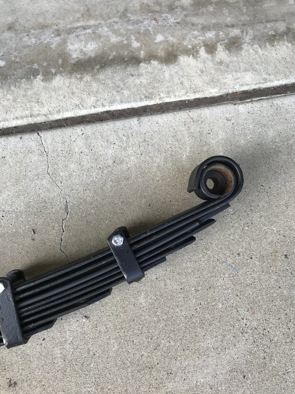

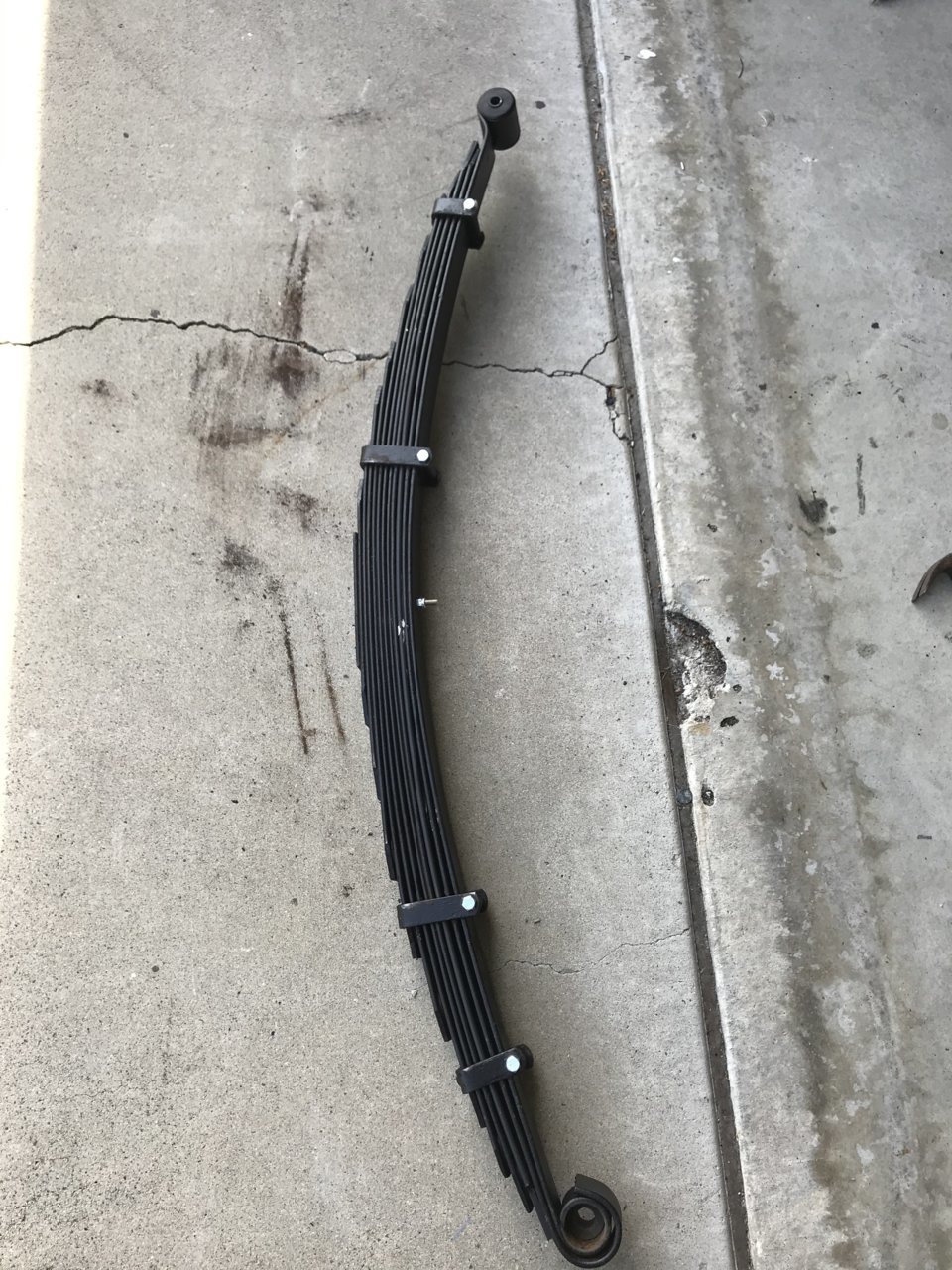

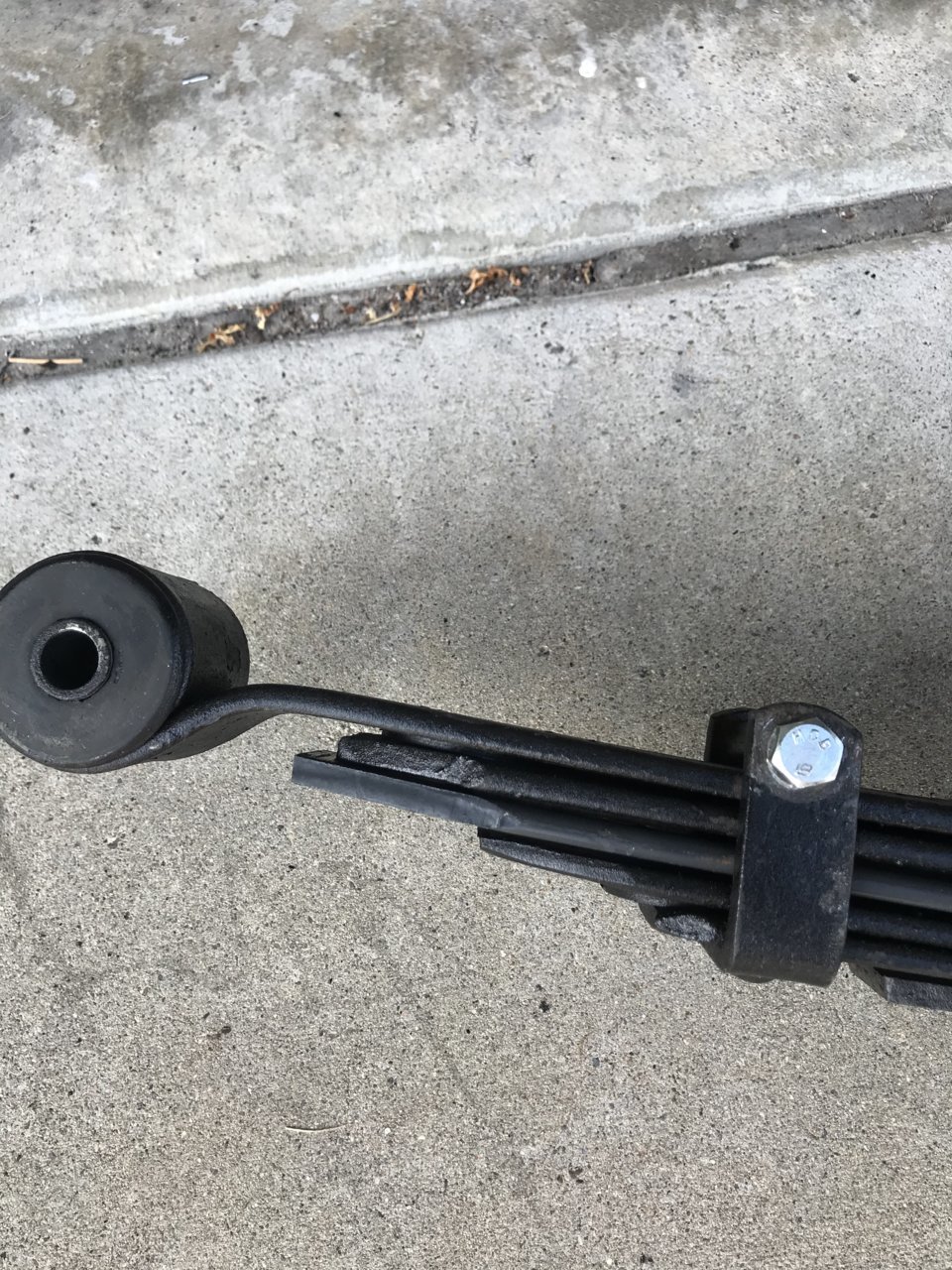

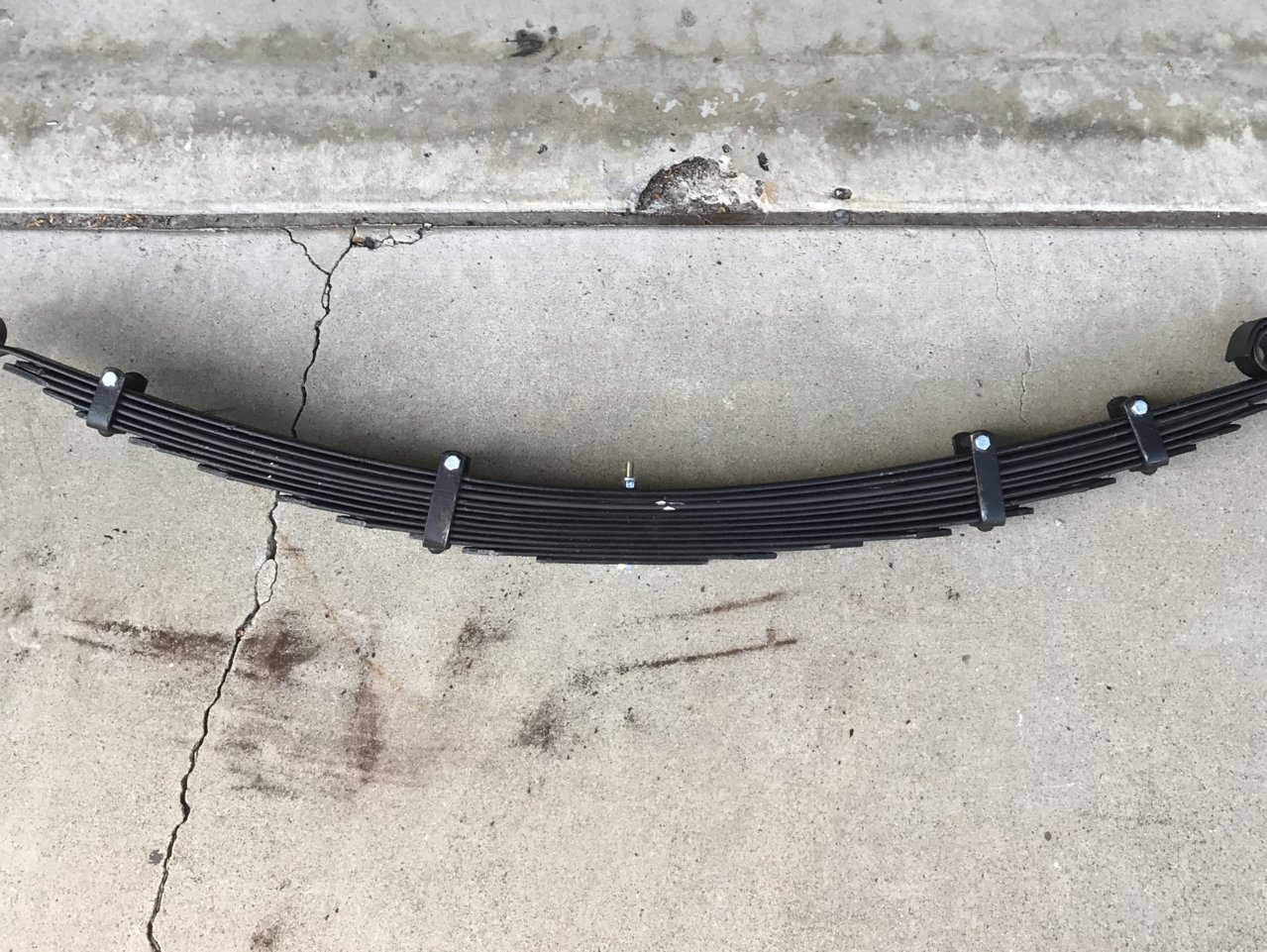

    Anyone else do this? Pics? I just got some all pro standards used, thinking about adding the d29XL leaf to them to make them more like the expo pack.

    I put the AAL in and the truck literally rode on the bumps....honestly not even sure that this was really an all pro standard pack.
    I swapped the AAL into my dakars and am much happier.

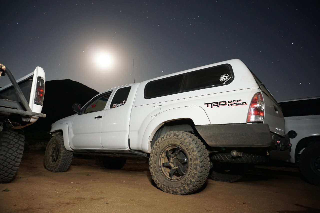

    For what it’s worth, I’ve been happy with my AP standard leafs. I do want to add the OME AAL because with the shell on the rear doesn’t sit where I want it to. It’s a soft pack, but not obnoxiously soft.
    If I don’t go AAL I’ll go forward with a 63 swap. It’s the better route, just more work.
    If you’re shopping for leafs and concerned about the softer characteristics of the standards, go with the Expo pack. Many people had told me the Expo back wasn’t bad without weight, I should have gone that way, but went with the standards.
    Just my .02

    If you are towing a set of airbags with Daystar cradles would be a good call to handle the TT weight even with the WD hitch.
    If this helps, here’s the best angle I could find. Added weight on the rear: fuel tank skid, HC steel rear, full size spare, shell, tools, camping chairs, cooler.

    Thanks for the pic too. Angle is a little hard to see. But, definitely not seeing any sag with the added weight. Thanks again @eccracer104.

    Yeah not the best angle, but gives you an idea. There are certainly better leaf options but I’m not unhappy with these. I do want to add the AAL or a 63 swap at some point.

    Did you you just a regular nut an threaded bolt for the center pin?
  17. Sep 1, 2020 at 12:25 PM
    #37
    anthony250f
    anthony250f Well-Known Member
    Feb 18, 2012
    #73066
    16,749
    Anthony
    San Diego, CA
    2008 dcsb trd offroad 4wd
    Yep grade 8 3/8” bolt and rounded the bolt head
