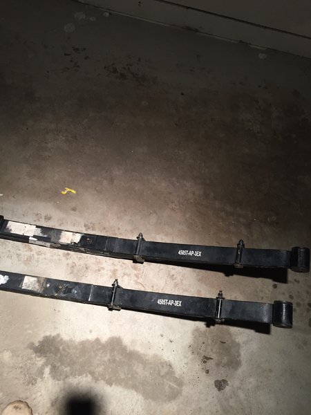

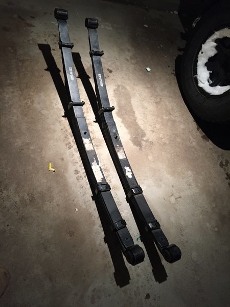

    Installing this lift tonight. So I
    Have the all pro exp pack rear leafs. Just curious if it matters left or right?
    And which ends face towards the rear bumper
    Thanks

    Does the numbers half go towards the rear bumper?

    Left and right are the same. Yes, the side with the part # goes towards the rear bumper.

    Good luck on the install. Hopefully you have an extra set of hands to help. I found when installing mine it made it easier to position the leaf springs into the right location upside down, and then with the weight on the axle rotate them over and line up the front, push through the bolt, line up the centering pin, and then line up the shackle mount and put in the bolt.
