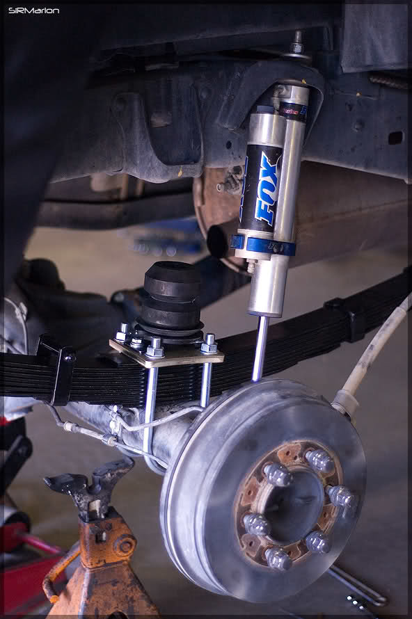

    here's my new setup..love it, rides great both on and off road, especially in the dirt..great match with the Fox's..tomorrow we're doing some more desert pre running..not our usual thing but fun as hell..all those whoops out there makes me appreciate how well these leafs ride, plus..with the Timbren bump stops no more harsh bottom out feeling..just a smooth bump..almost feels like i have the more expensive hydrolic bump stops..but mine are more affordable haha...
    3" leaf pack, Fox adjustable Resi's, u-bolt flip kit, Timbren bump stops, and extended brake lines..

    those are the same shocks i got, had to wait 3 months to get them, are those adjustable.

    ...they are the adjustable ones that i have, worth every penny if you ask me. seems that All Pro has the exclusive rights for the Fox adjustable C/O's and rear shocks for our trucks...each click makes a noticeable difference in the way they ride..impressive haha...i think "3" rides the best overall...what do you have yours on?
