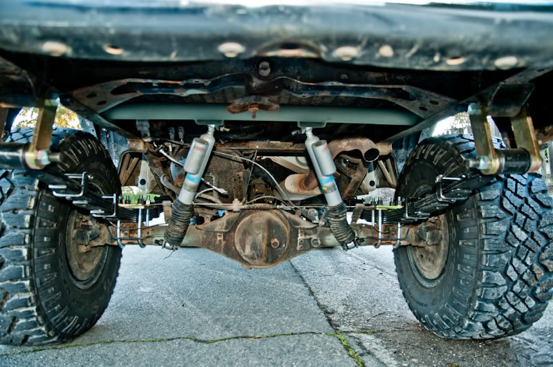

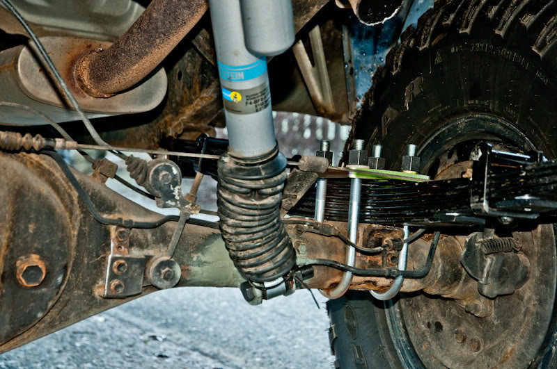

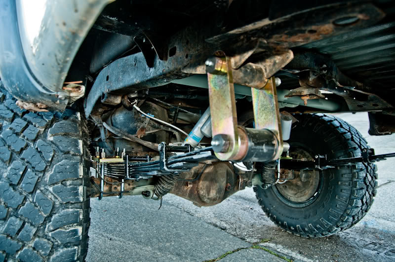

    Well it's been 4 months and I finally installed the rear suspension.
    AllPro Expo Leafs
    AllPro U Bolt flip kit
    AllPro extended shackles
    Extended brake lines
    Custom shock mounts welded to the Axle and a new cross member between the frame rails.
    DayStar bumpstops I still need to install this week.

    Nice. I'm looking at these springs with 5150s.

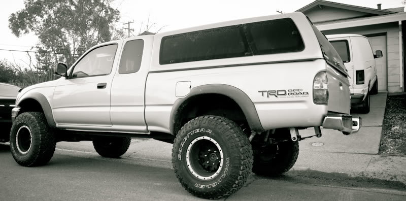

    The ride is awesome! the last picture my truck id loaded with about 400 or 500lbs of crap and a camper and I'm still sitting pretty high so If you don't load your bed up or have a shell you should conciser that your truck is going to be sitting high.

    I have 420 pounds of bags in the back, so I should be fine. What valving are the shocks?

    255/70

    Nice, the same valving that I'm planning on getting.

    Yeah it's good for single shock applications
