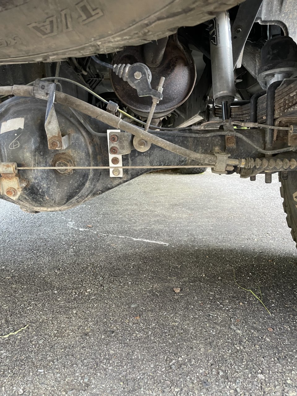

    Do you have a pic of the bracket? Right now my brackets are wired up out of the way. I concur that the Exped 2.0s are sweet. I love the firm ride and no more sag! Running an Ikamper 3.0 with a Voodoo bed rack and retrax top.

    Yep, I just used this bracket from Amazon. It would be really simple to make if you had some material and a tap and die set.
    I meant to say this was to extend the proportioning valve. It may not be necessary but it gave me peace of mind.
    Supreme Suspensions - Brake Line Anti Skid Valve Drop Bracket for Toyota Tacoma and Tundra (2WD 4WD) Pro https://www.amazon.com/dp/B07N93GKDM

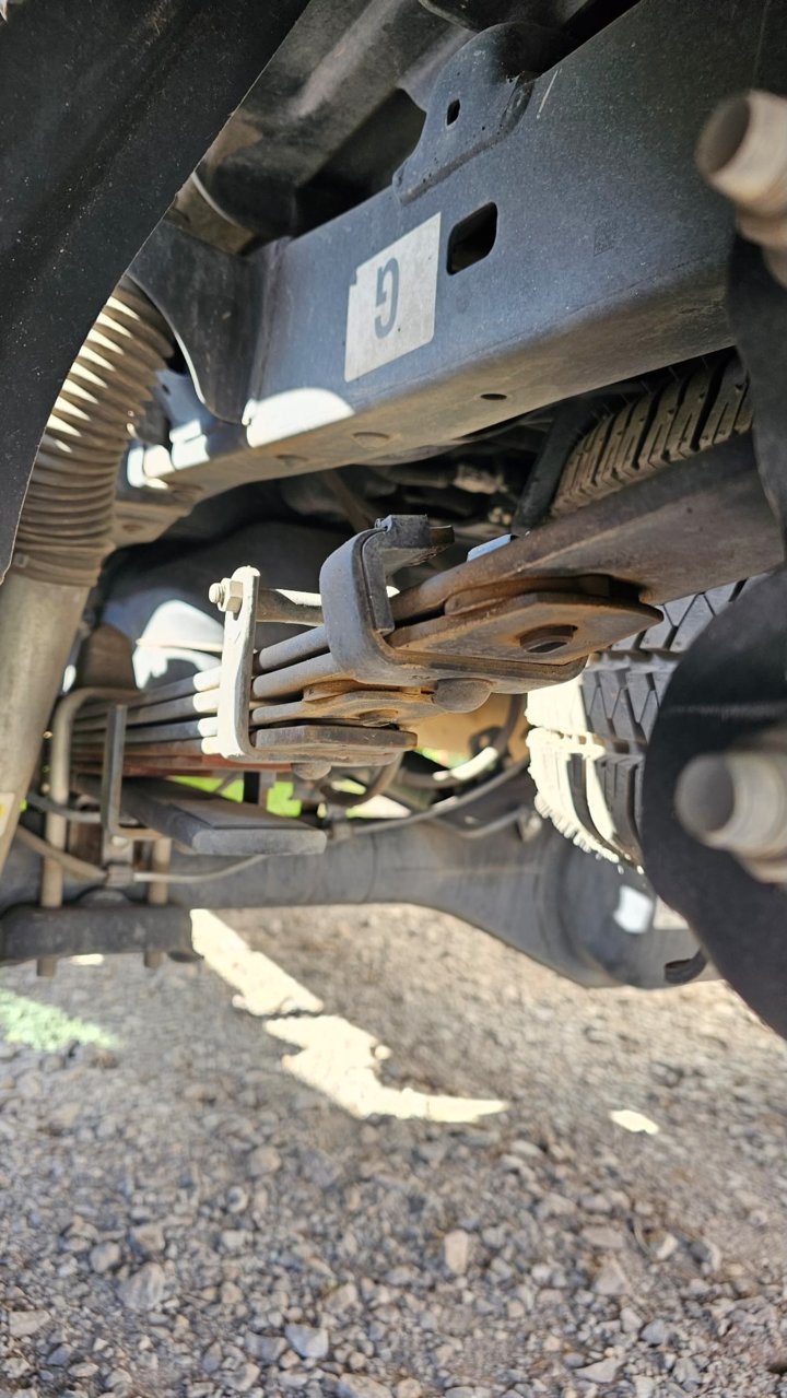

    I can't speak for All Pro springs, didn't go that route. I went with OME/ARB expedition pack w/AAL, and later added a set of Icon progressive overloads. I set them up along the same lines as Phessor did, opted not to remove the OEM overloads. I like the ride, both before and after the Icon addition. The main reason I went with the Icon overload pack is that I frequently tow either a box trailer or a 10' utility trailer and regardless of load or empty, the Tacoma still had the Toyota sag going on.
    I also generally haul 300-600# in the back of the truck + topper. Now even with an additional 400# of wood pellets in the back it sits pretty good.
    134A8028-0967-4AAD-B2FB-356646B62403.jpg 6220BE28-C92A-4B9D-9B79-06926E2F6989.jpg
    Also with the older Tacomas', one has to deal with the parking brake cable/leaf spring conflict( i don't think yours will have that issue. I had to fab a BPV bracket, as well as raising the cable guides:9FD35983-CD39-4A2D-BFC9-242CDF1AF89B.jpg
    These pics are post front axle replacement and new Falken Wildpeaks 255/85 R16 on stock Toyota rims.
    Feels very planted on the road , even when empty.
