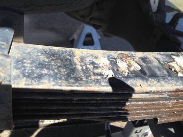

    I put these "brand new" leafs on when i lifted my rig a few months ago (maybe a few thousand miles on the suspension) I was hinted that i may have a lemon pack due to it's stiffness and firm height in the back.
    Anyways i was cleaning everything yesterday and when i took the tires off i notices all of the rust - not sure why :confused:
    I live no where near salt water and i have done very little off pavement since the new lift.
    (Leafs are a bit wet from the water) It may look like dirt but i assure you it's not.
    Since i'm here i may as well post this up: There was some controversy over my leafs being a lemon pack as well due to their lack of sag even when towing, they are indeed the "standard leafs" as verified by the code on the packs themselves

    You sure you don't live in a rust belt ?? Looking at your Ubolt, its rusted to shit !!.....:notsure:

    My stock leafs weren't rusted when i pulled them off...

    I agree bare metal should/would rust. But how on earth does all of this paint come off and rust in less than a year... that's odd to me. Especially when my stock leafs were 10 years old with ZERO rust.

    Rust happens. Would be awesome if there was an affordable way to completely eliminate it. I would just power wash them. Let them dry all the way, and hit them with a $4 can of Rust-Oleum.

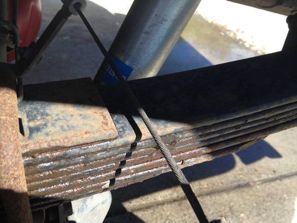

    Even though you don't live in the "rust belt" you do live in Oregon that is a pretty wet state (unless you live on the eastern side or Oregon). Even if you don't go offroad much there is a lot of road debris that get kicked up from regular driving and can basically sandblast your undercarriage. To me the rust on the leaves looks normal for what I see on leaf springs. Did you reuse your stock ubolts when you put the AllPro leaves on? Because your ubolts looks extremely rusty which tells me your environment is very wet and you are dealing with road debris, and possibly salted roads. The fact that the ubolts are that rusted tells me that the springs are not "lemon" springs as far as rust goes.
    If they are not flexing like they should that is another matter and Allpro has asked you to contact them to discuss options.
    Also you need to remember that leaf springs are constantly moving and rubbing on each other that will expose bare metal over time which is going to rust. That's just how it goes.
    I normally take a wire brush to my springs once a year and give them a fresh coat of paint to keep them looking decent and protected.
    Example:
    My springs this past february. Pretty rusty and dirty from the winter driving (all on road).
    Same springs about a month ago when I did a ubolt flip. When things were apart I wire brushed and painted them.
