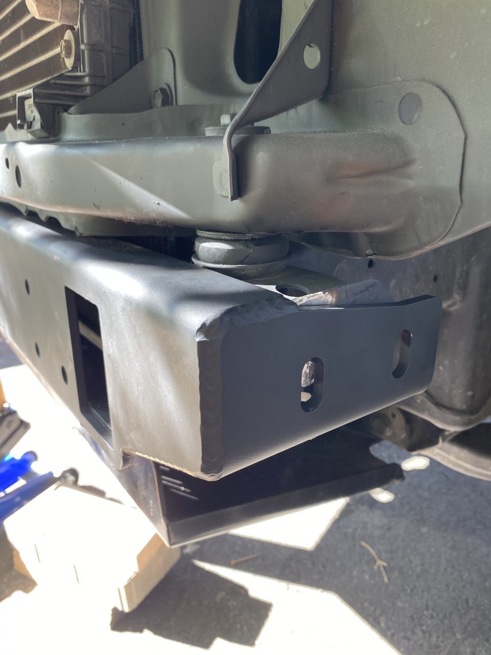

    with the link kwik posted there just small tabs right? Mine came with a thin piece of steel maybe 1” x 2’ with nuts welded on separate from the bumper and mounting plate, thinking it’s skid plate mounts or something.
    I called all pro and they were useless in helping me lol. You don’t have to cut off or even mess with the original front Ifs skid plate mounting locations to put this bumper on do you ?

    Yeah it's just the end point just past the nut. The link shows the photo perfectly. No messing with the stock skid mounts are necessary, but you can't run the skid (obviously)

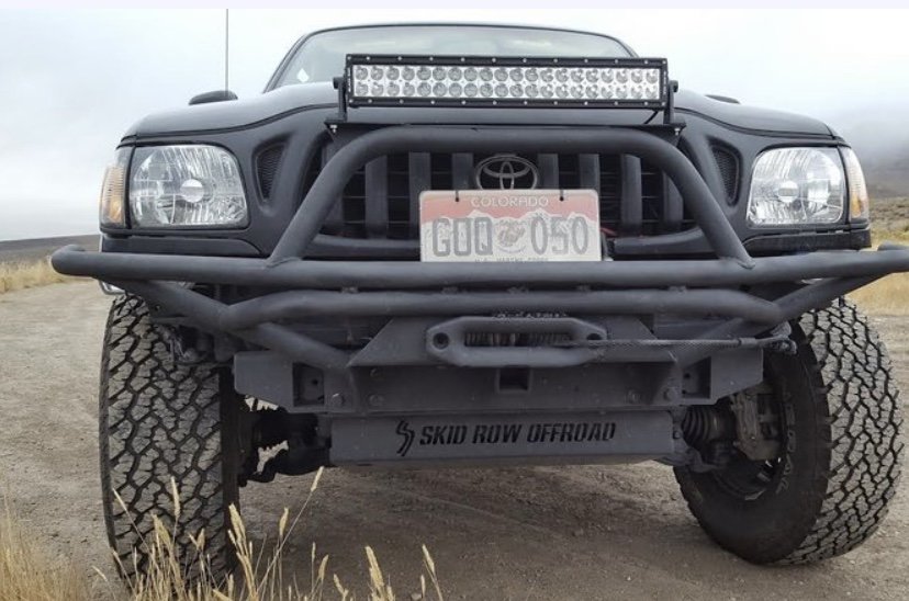

    All right. I’ve been so busy with work haven’t even had to time to take my bumper off and look. I have skid row skids in already and I’ve seen another first gen with the bumper and skid so it will work somehow lol. Here’s his truck E4F04DBA-3F95-4A9F-A4E4-BE00CFF15847.jpg

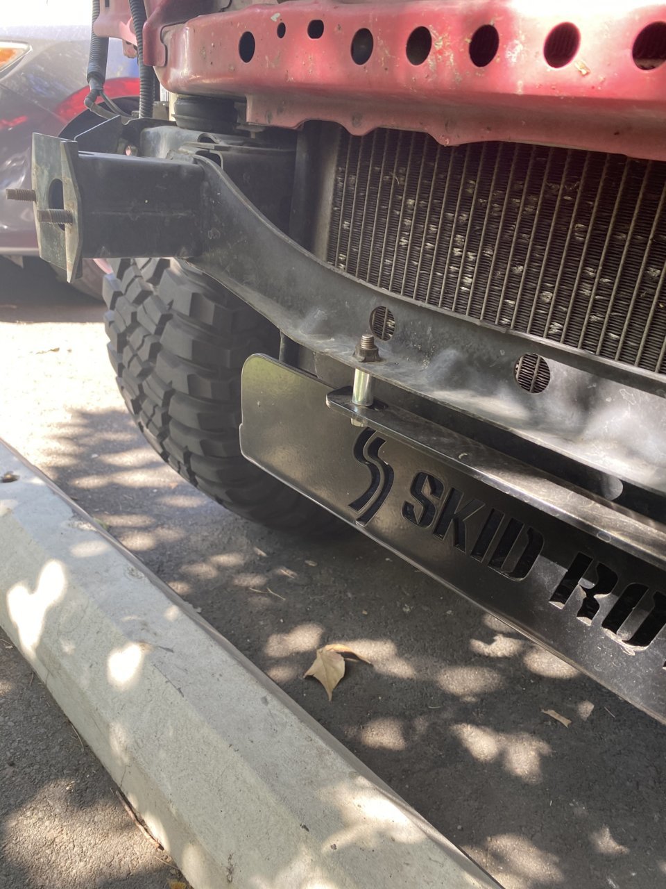

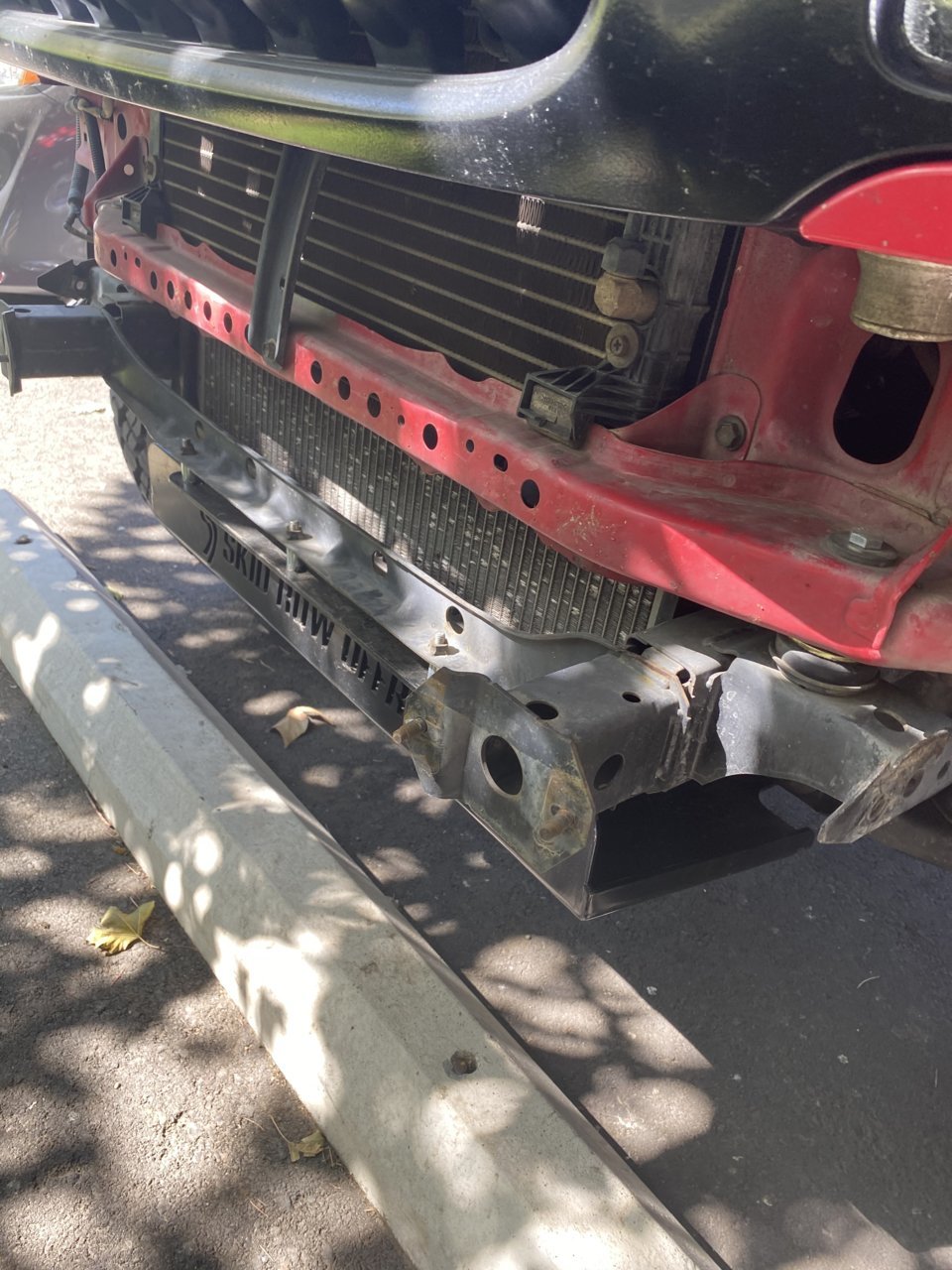

    Just grabbed some photos
    Initial install
    Jguardino[OP] likes this.

  15. Sep 10, 2020 at 1:54 PM
    MFTheo
    MFTheo Active Member
    Jul 4, 2020
    #333349
    35
    Theodore
    Sacramento, CA
    2002 DCSB
    That's not the same bumper though. I've read that the all pro bumpers can only use AP skids, but don't quote me on that.

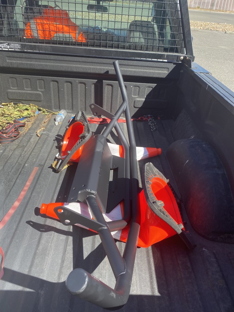

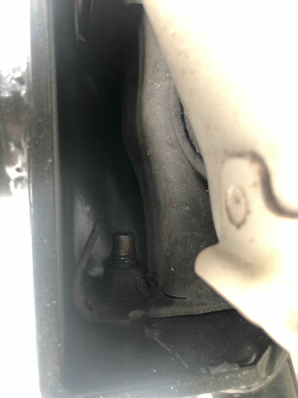

    Hey all just got my bumper, does the crossmember come off that holds my skid? I’m guessing I shave off those two tube steels poking out? 8DD97EF4-4327-493E-BBBD-EFBCB74D9E82.jpg
  17. Sep 22, 2020 at 5:25 PM
    #17
    tacotime1
    tacotime1 Well-Known Member
    Apr 8, 2010
    #34849
    577
    There are bolts inside the front frame horns. Unbolt that and the skid plate bolts. Then you need to cut the Triangle parts of the mounts on the side mounting areas

    alright sounds easy enough, I’ll have to figure out the skid next

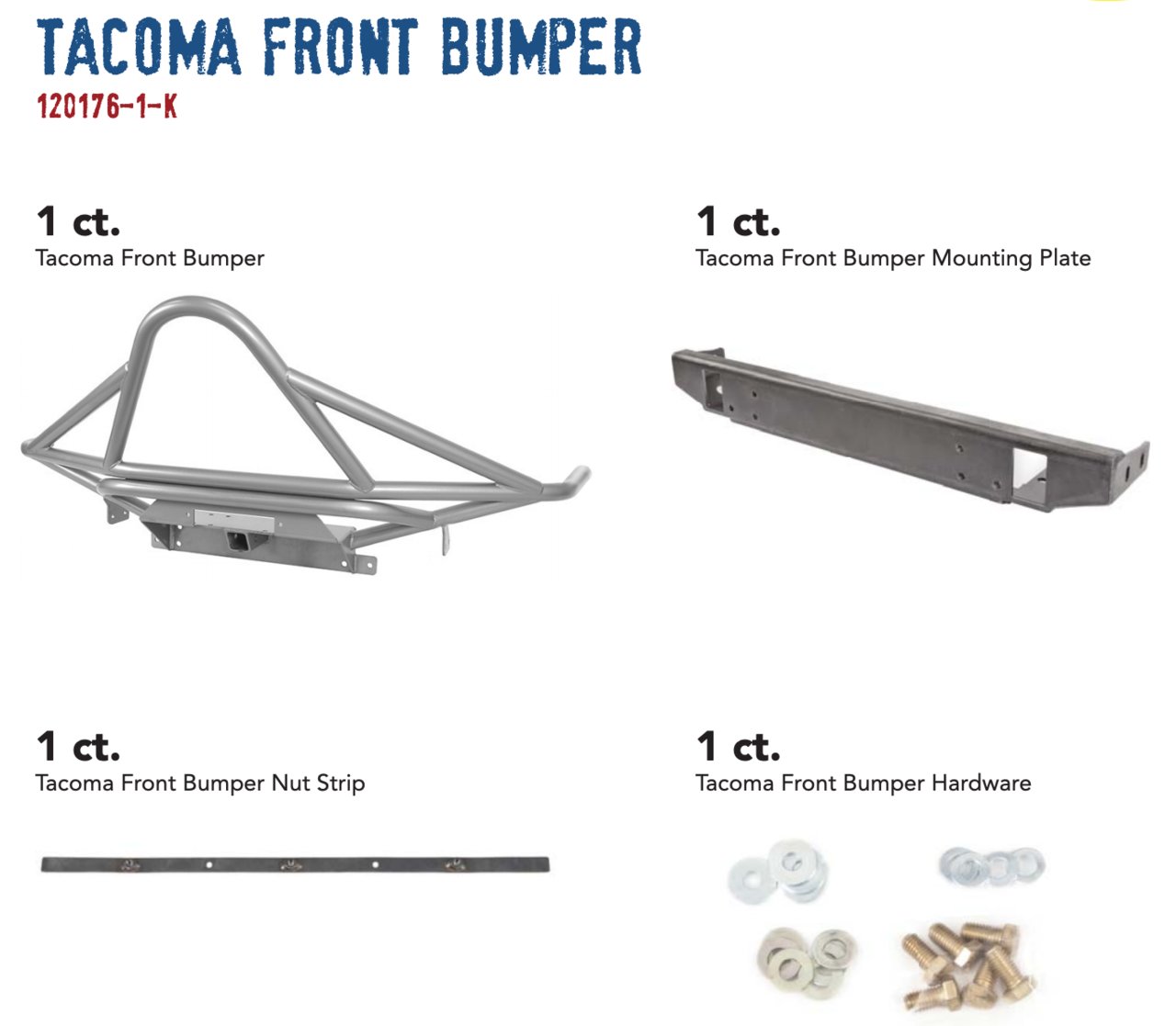

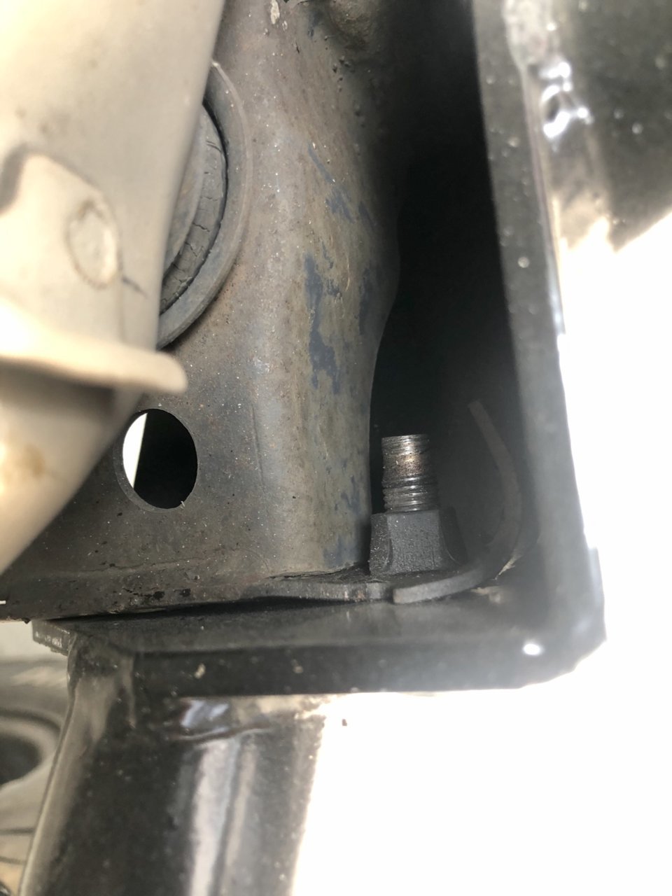

    What is my
  20. Sep 23, 2020 at 5:31 PM
    #20
    Dalandser
    Dalandser ¡Me Gustan Las Tacos-mas!
    Feb 19, 2015
    #149090
    17,635
    Anthony
    Downey
    08 PreRunner Regular Cab / 98 4x4 Extra Cab
    Empty Wallet Mod
    Remove your skid - the *Trail Gear* low profile bumper you are installing has a nut strip to replace that cheesy paper thin sheet metal cross member that your skid is mounted to. I had to cut sections of mine out instead of cutting it out, but you may have a specifically unique area(s) to clearance it due to yours being an 01 and mine being an 98 with varying front bumper / frame details.
    Did you buy that new or used? If it was new, it should have come with the strip you lay in the mounting piece you are showing us a picture of that doesn't fit that you will bolt your 3 front skid bolts into.
    It's the "nut strip" in the installation instructions:
    https://trail-gear.com/downloads/pdf/instructions/120176-1-k.pdf
    Here's something to guide you - @DJB1 just cut more frame out than you.
    https://www.tacomaworld.com/threads...ow-profile-bumper-for-1st-gen-tacomas.441752/
