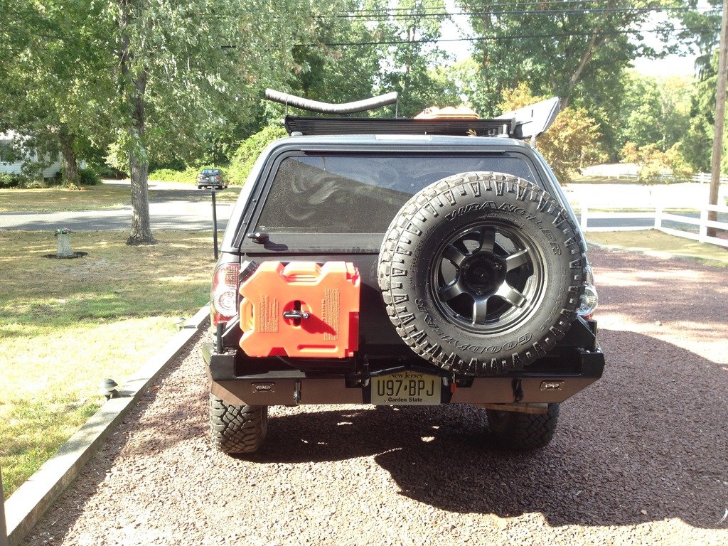

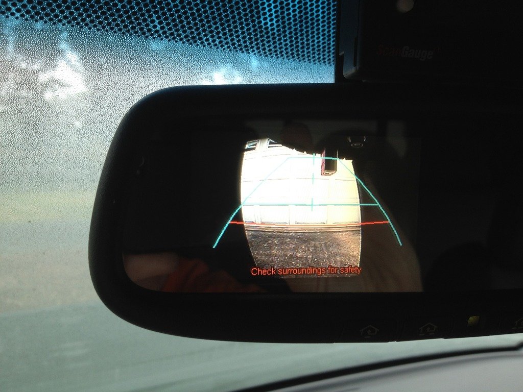

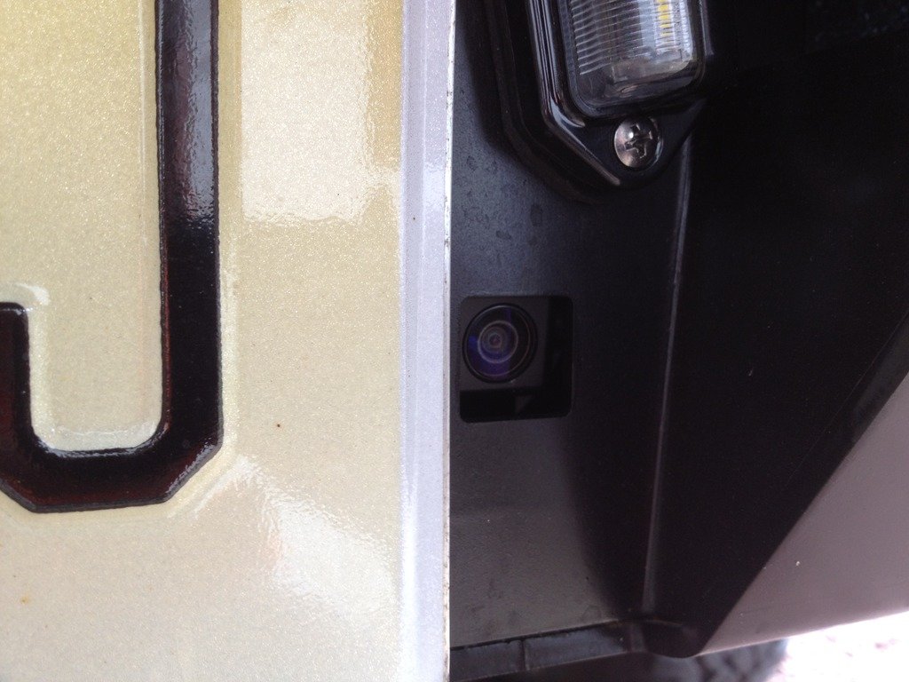

    Does anyone have an pictures of what the camera looks like on from the inside, as to if you could still see enough to hitch a trailer and also work as a backup camera for maneuvering.
    Also would there be any way to have a combination of a 33" spare and 8 x 2 gallon rotopax or similar capacity together on the bumper?

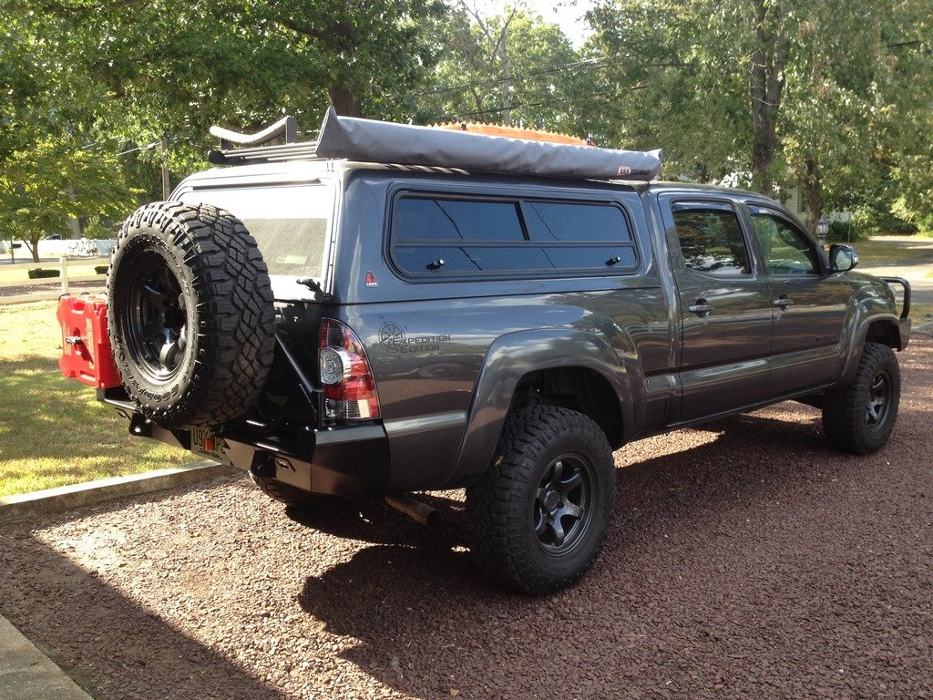

    I don't see the relocated camera working for trailer hookup. I have the same issue so I picked up a second camera and harness off another forum so I can have the one in the bumper by the plate for every day use and the one in the tailgate handle for trailer hookup. I'm going to wire through a DPDT switch so to hitch up, I'll open the tire side carrier and latch it in the open position, flip the switch to turn on the tailgate handle camera, and back up and hitch up.
    I snapped some shots inside and out for you - the camera is still ok for backing up but the lines are obviously off due to the new angle/height. You also lose a bit of width but some spot mirrors cover the gaps for me so I can still catch parking stripes when backing into spots. The red line is ~4' behind the back of the truck now including cargo on the bumper. The warning text corresponds to the back of the truck now.
    As far as cargo goes, I'm running ~31" tire with three 2-gallon Rotopax (see here).

    Not sure if the replacement camera I bought is the same as OEM, but it was for my Gentex mirror. Anyway, there's a loop of wire near the camera side that you can snip and the lines will go away.
    If you wanted them gone, you can check for it.

    As far a the rotopax is concerned, I inquired about that very thing with Tracy at Allpro. She said presently they only offer a setup that support the use of the 3 gallon containers.
