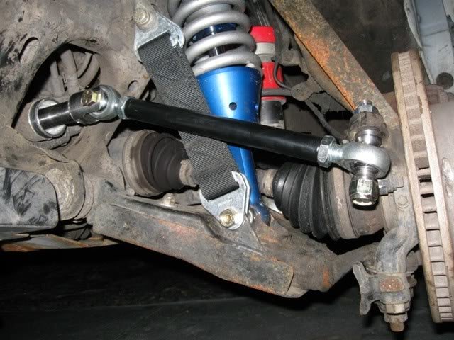

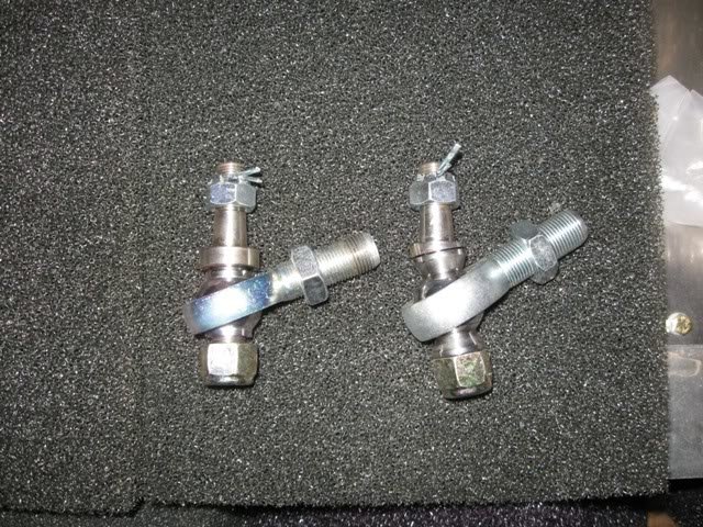

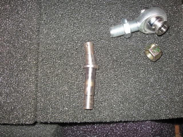

    Yep. That's exactly what All Pro's kit is designed for.
    Stock vs. the All Pro setup:
    If you are running a lift and/or extended travel coilovers, they offer this really cool setup that'll handle the extra travel without binding. I have no idea how that angle piece is machined but it's a work of art.
    The new kits come with a boot to cover the end of the power steering rack.

    jack the wheels up and grab the tire from either side and shake. if you feel play, they're bad.
    not a fan of the lack of lubrication points... or that they are completely open to the elements... doesnt seem like they would last too long
