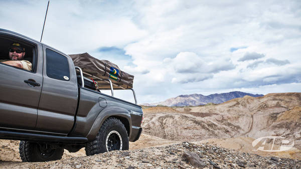

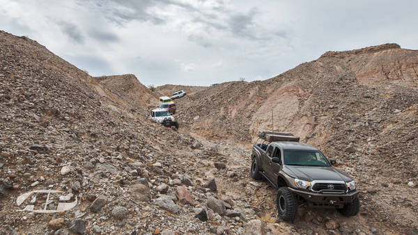

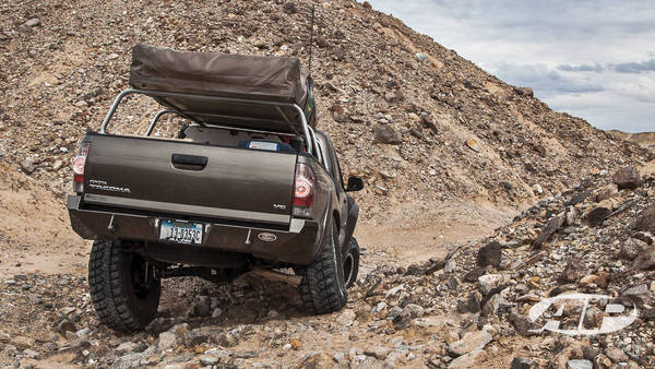

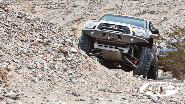

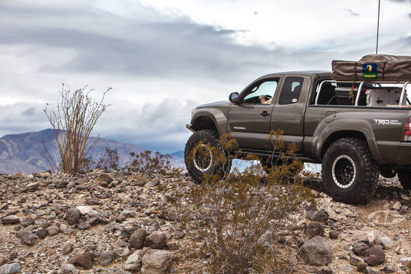

  14. Mar 8, 2014 at 12:48 PM
    #174
    allpro
    allpro [OP] Well-Known Member
    Oct 17, 2008
    #10025
    1,689
    Montana
    All Kinds Of Toyotas!!!

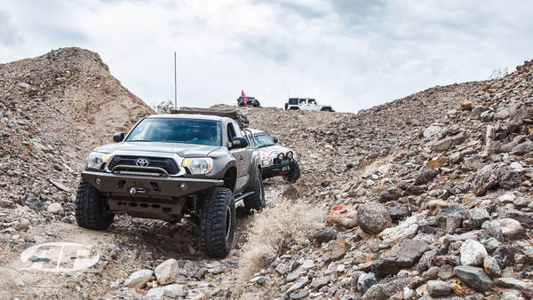

    We have sparked quite the discussion on fitting 37's. It is no easy task as some of you have realized and tackled already – more modification will be needed and we will be updating you all as we go but...
    We want to step back though and kind of clear up the overall purpose of this build.
    This is an Overland Style build, not a Crawler. So even though the suspension will get put to work going through rough terrain in the back country it will also be a comfortable daily driver so if you wanted to take a long road trip and not be beat up by a typical SAS you can. This will not be put through the rigors (on purpose) of what a typical "crawler" would which is why we kept this an IFS build with our LT kit.
    Here are a few shots going through some trails at TDS.
    This was our first chance to really test the rub points of the tires. We will keep you all updated on what we come up with for easy solutions on the rubbing.
    The_Black_Pearl likes this.

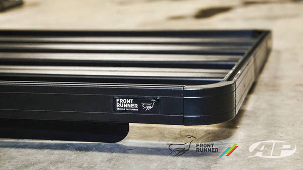

  17. Mar 8, 2014 at 7:19 PM
    #177
    allpro
    Oct 17, 2008
    #10025
    1,689
    Montana

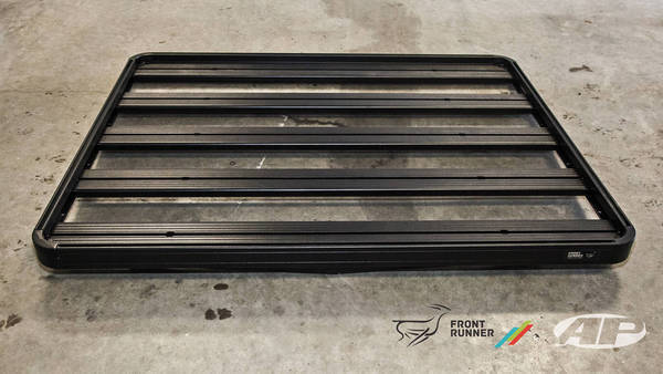

    When it comes to roof racks on an extra cab Tacoma there isn't many options due to the lack of factory mounting holes.
    We knew we HAD to have a FrontRunner Outfitters SlimLine 2 so we talked them into making us a custom length one - we don't mind drilling a couple holes to mount it :)
    Install coming soon!

    ^^ that's cool!
  19. Mar 8, 2014 at 8:24 PM

    Thank you for helping me pick my roof rack over the cab :D been looking for an access can rack

    Sweet! We will be twins :D
    give FrontRunner a call and ask for Steve, mention to him that you are looking to get the same All-Pro rack and he will take good care of you :)
