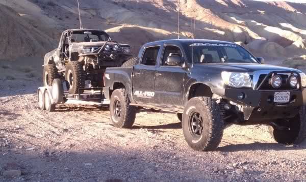

    ive had nothing but good experiences with the AP expo springs..they are great on the trail while still having the needed flex. they feel good driving around town. and they handle weight well, especialy towing..
