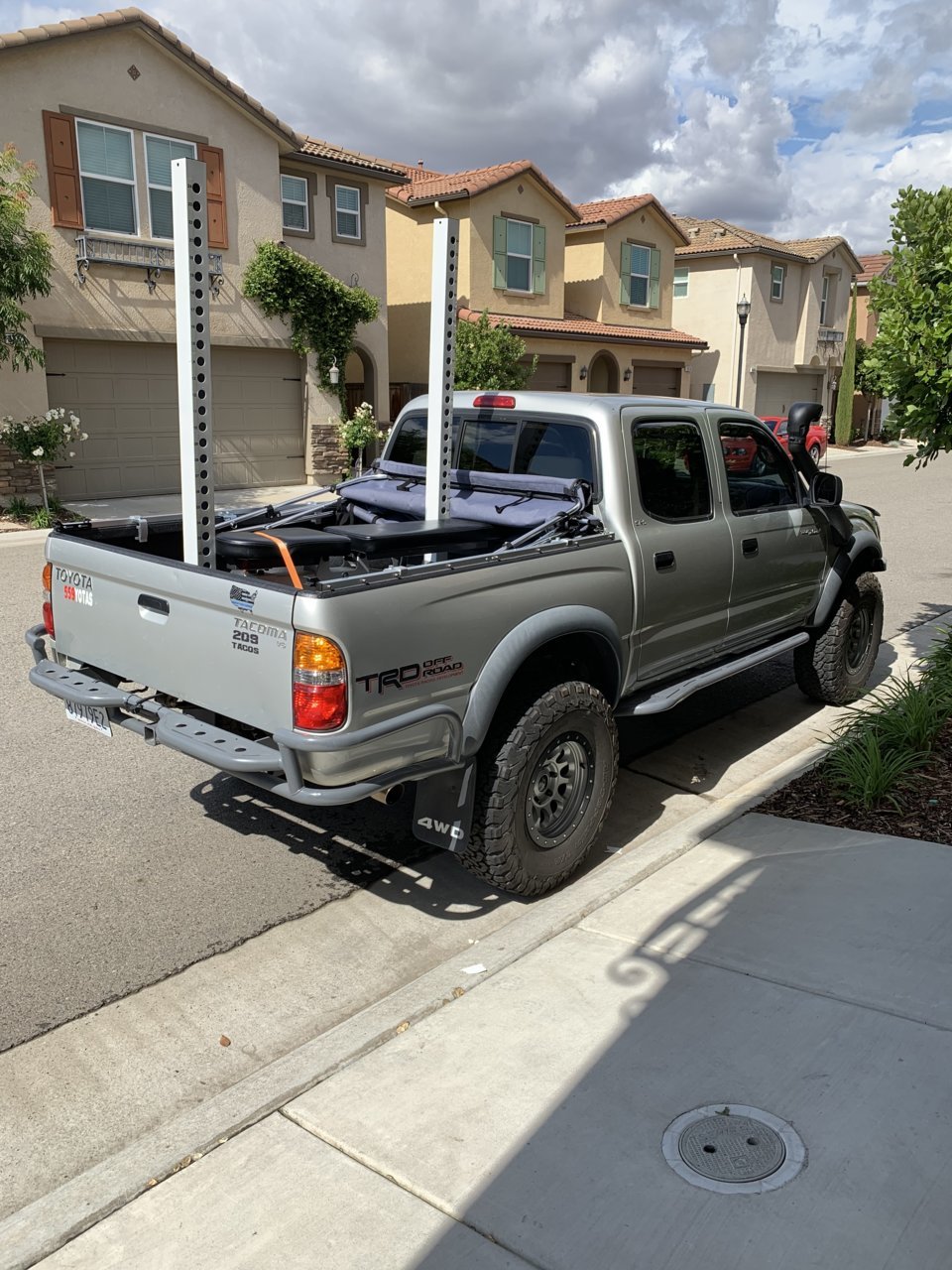

    Contact TG and they should be able to do a replace free of charge. I had this same issue and since I was local I went to their HQ and had them replicate my problem when they tried to mount it. I think mine was a centimeter off. It’s a solid mount point and there’s no way to move/bend it to fit. Keep us updated.
    I’m assuming it’s this one?

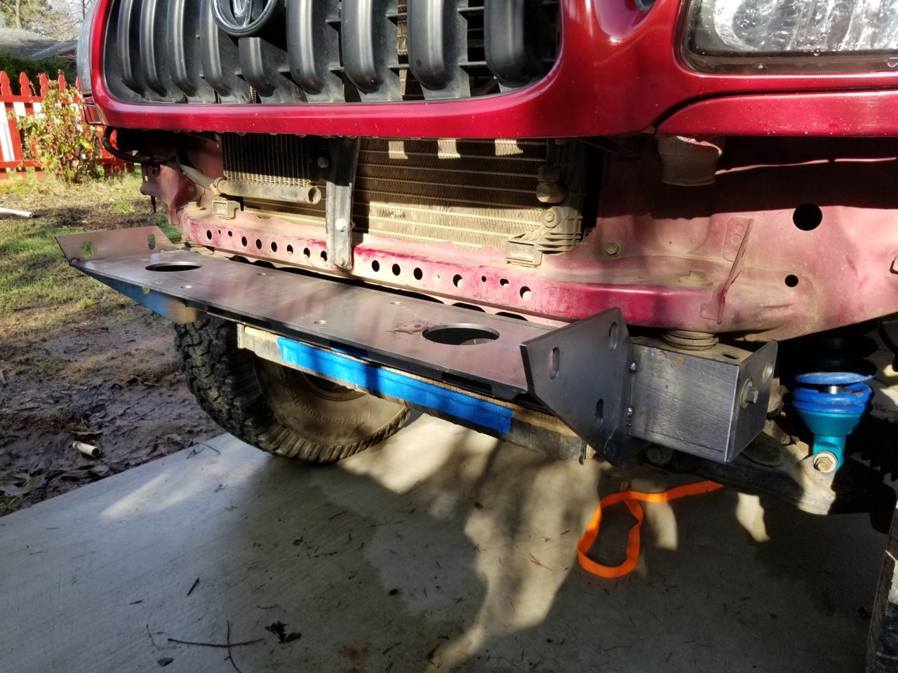

    Had a similar issue with my CBI DIY front bumper. Of course my issue was 100% my doing (since it's a kit), but I ended up with one of the vertical plate only an 1/8" too narrow to fit over the winch mount plates.
    1/8" doesn't seem like much but the only solution was :sawzall: and :welder:
    Vertical 1/4" plates here: had to cut one off and re-weld it since the part of the bumper that mounts to this is completely integrated into the plate bumper.
