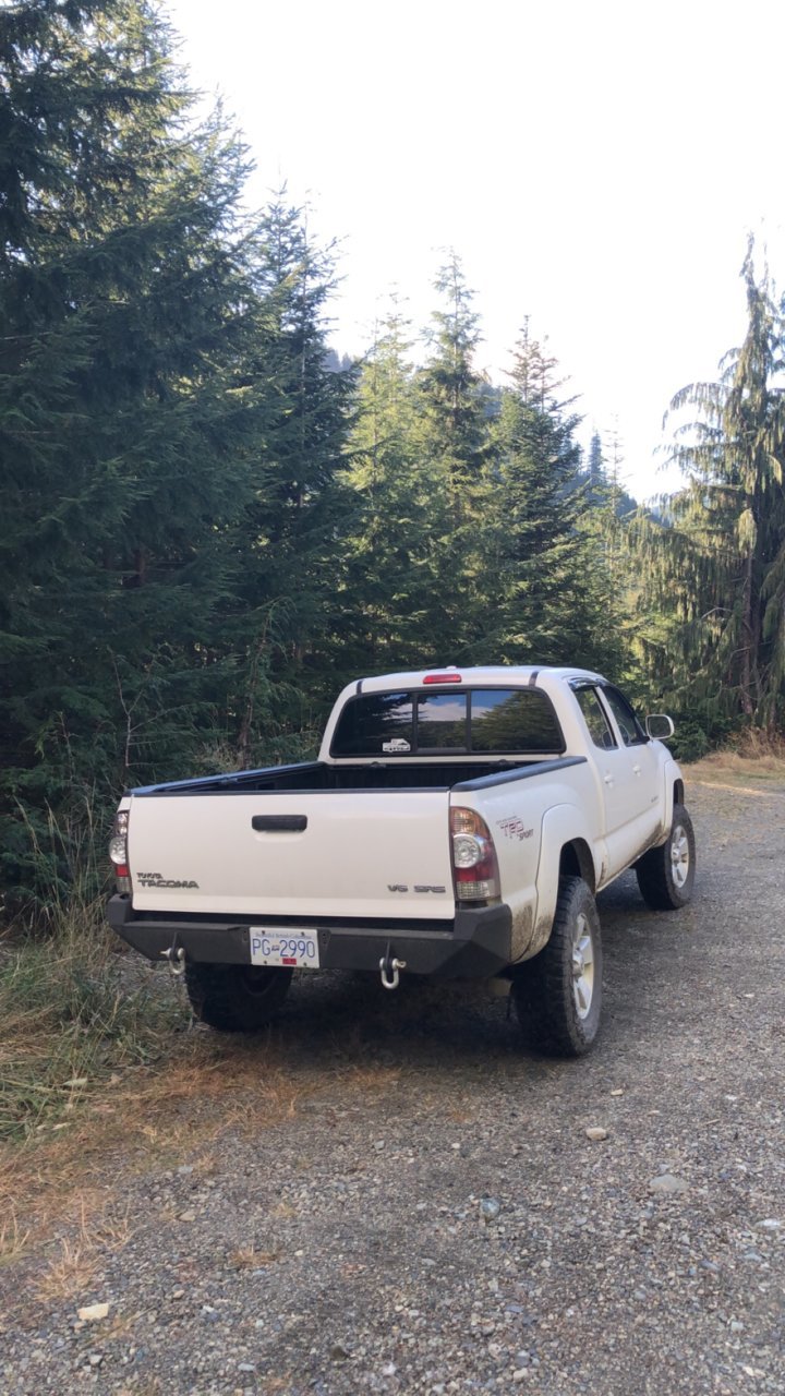

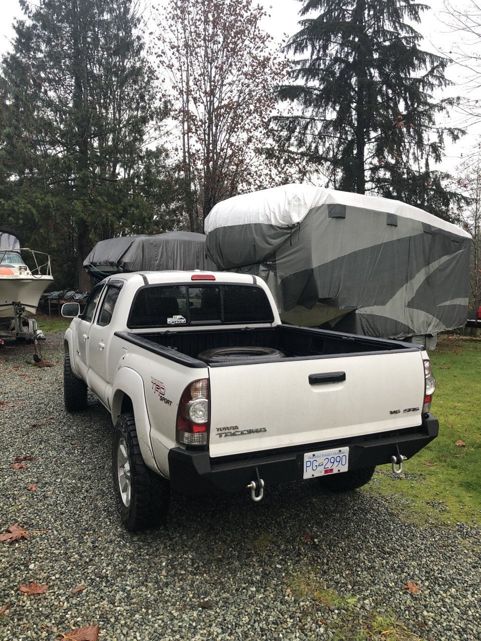

    Hey everyone just wondering if anyone could help me with this, I bought a all pro rear bumper used awhile ago and it doesn’t sit how I want it to, I contacted all pro to see if this was correct fitment but they even said it doesn’t look right, there is a 1 inch gap underneath driver tail light and passenger side has a 2 inch. It’s pretty noticeable and I have yet to figure out why I was thinking maybe the bed isn’t aligned, but haven’t checked yet also I put a level on the rear bumper and it’s level not bent.

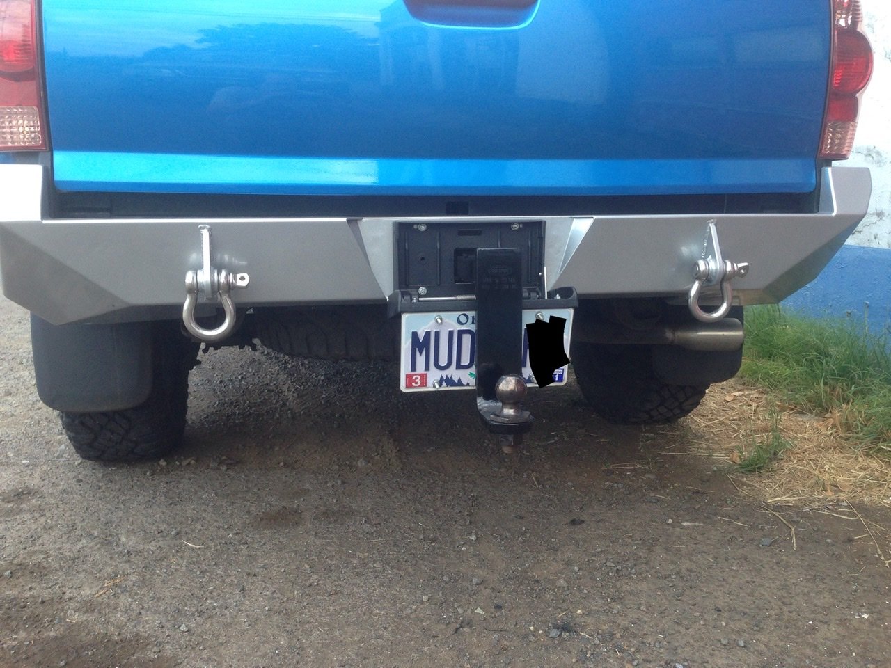

    Muddinfun
    Muddinfun Well-Known Member
    Apr 17, 2017
    #216500
    7,489
