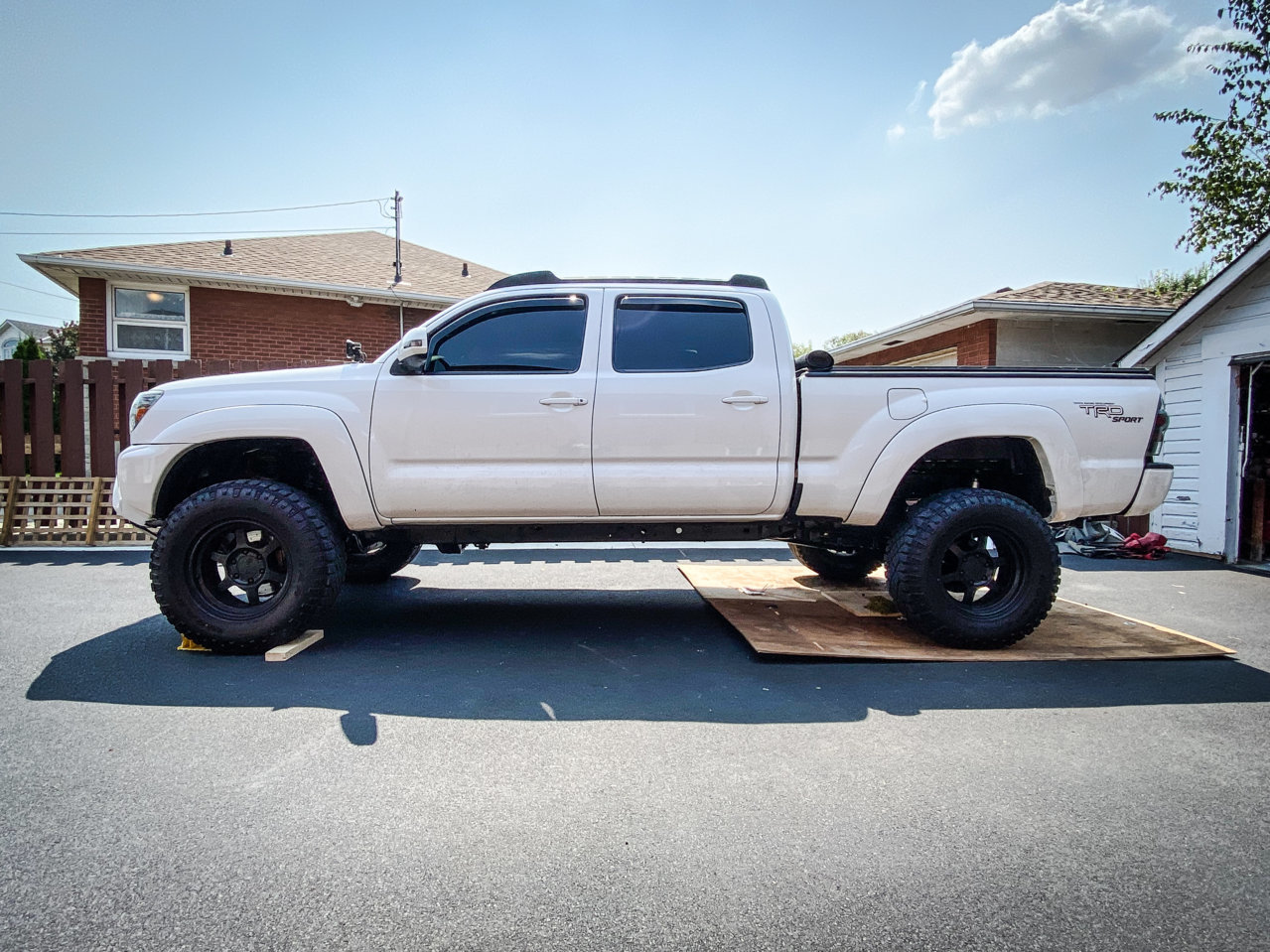

    Extremely happy with my Expedition All Pro leads. They ride great and I’m 99.5% if the time it’s empty.
