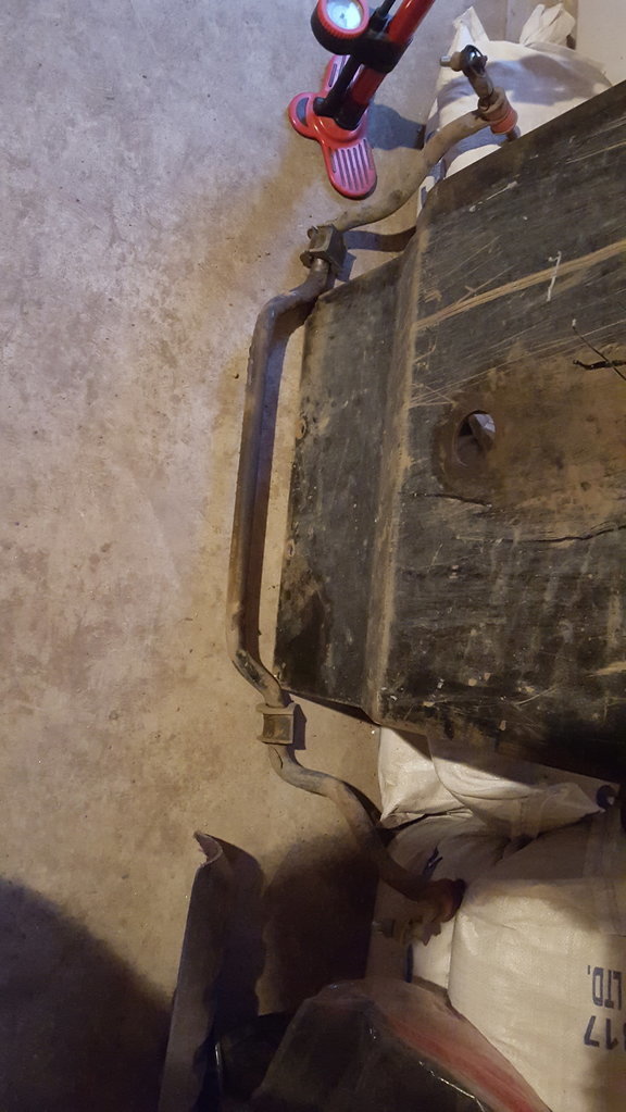

    Removed the sway bar last night, but ran out of time to put the skid plates back on. Sway bar has a four inch plane on it where the skids rubbed it down and flat. I'm guessing that part of my noise is from the obvious skid to sway bar contact.
    I'll put the skids back on tonight and see how much noise has been eliminated with the sway bar removal.

    Because everybody likes pictures. What appears to be a crack on the sway bar past the bushing is just a rust flake.
