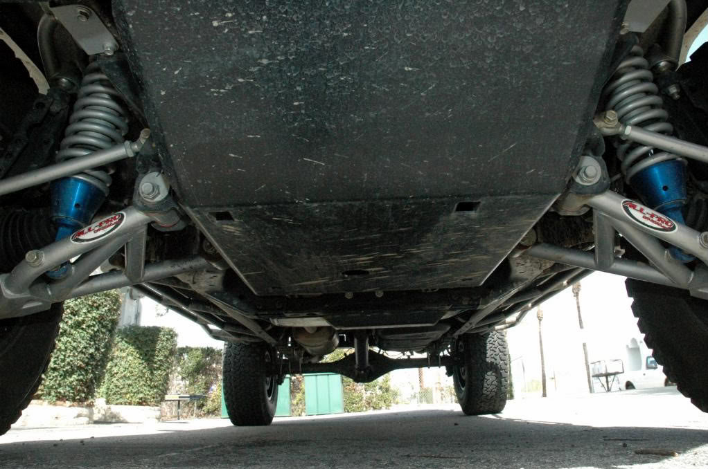

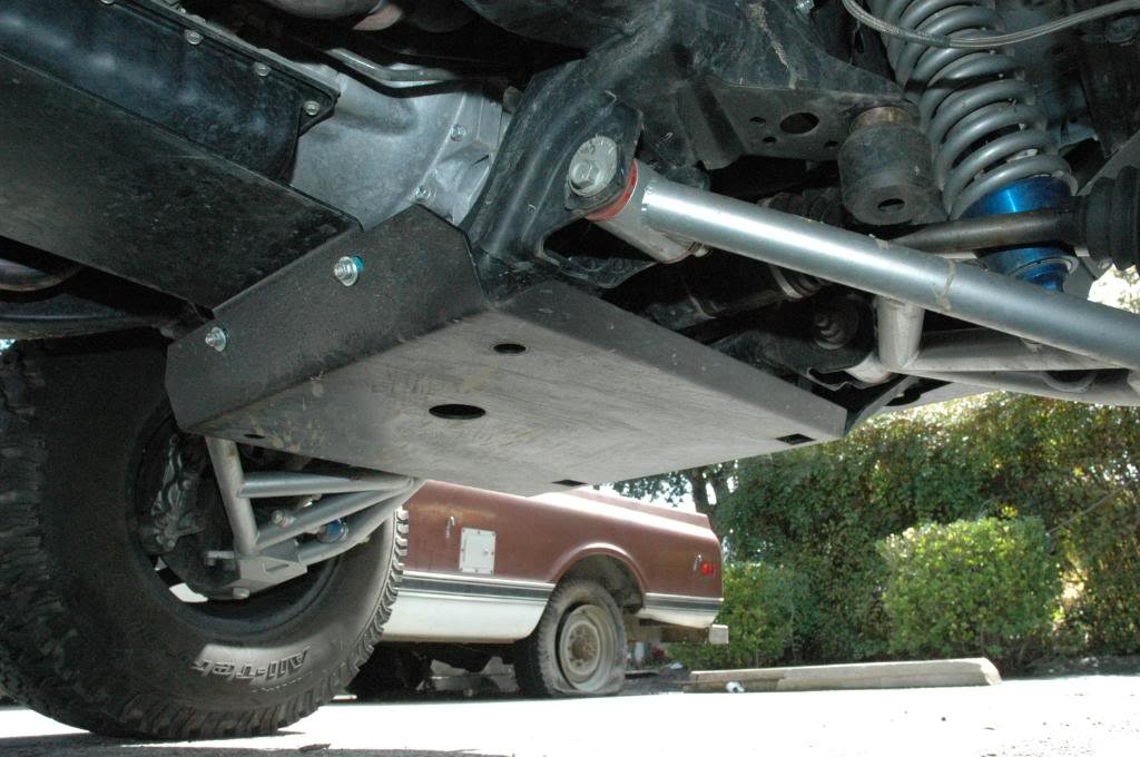

    For comparison, compare the BB skids that follow the frame or lower throughout the length of the skid:
    With the All Pro that follows the contour of the drivetrain - it does not hang lower than it has to and is the same 3/16" thickness as the Buds

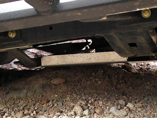

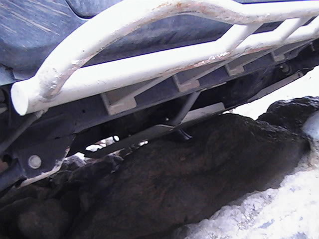

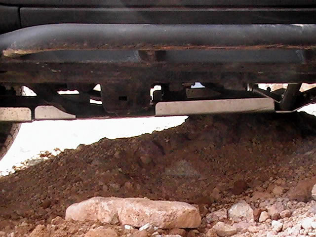

    Here are some great pics taken this weekend of FJ's at Calico during a TTORA run, all show the BB skids hanging low enough to high center the vehicles on this rock, and its clear that they do NOT hug the frame as close as possible by all the daylight visible above the skids, they actually have LESS clearance than stock.

    Hummm How could you possibly bolt something under a truck and give it MORE clearance than stock? Teehee! :)
    Let's think this thru logically:
    The lowest points on a Tacoma ( or FJ ) are the a arm mounts, and the stock exhaust crossover. Bolting a skidplate under either of those areas REDUCES your ground clearance. But it increases your protection. Both the AP and BB skids do that!
    As Terry pointed out, our 2 companies have different approaches to protection. A smooth bottom does work well for sleds and other things that must drag over uneven surfaces. The AP transmission skid IS 2.5" higher than ours at that point. So if you got a rock up in there, it would not hit your skid. But, unless you slide out sideways, how will you get over the 2.5" lip at the front of the stock transmission crossmember?
    And, since the exhaust crossover is the lowest point behind that, and we both have clearance under it, then steel under that, the ground clearance is the same there. But having a smooth surface, or a long ramped surface will allow you to drag it over the rocks, instead of catching on the dropped area, that is perpendicular to the direction of travel.
    And, just a comment on those pictures of high centered trucks.
    Do you think the 2 lips that we just discussed would have allowed those trucks to proceed, or would they have high centered too? Perhaps hung up more? Which would you like to winch or strap out? Flat or lipped?
