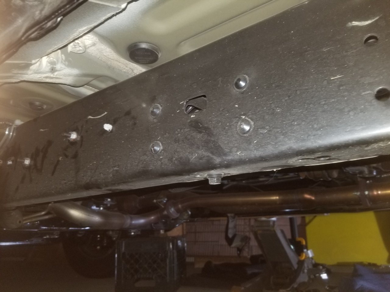

    I am looking for anyone who has installed All Pro bolt on sliders. I think I have extra bolts. I am not sure where to exactly use the nut bolt plates. I looked at the instructions but not very detailed. I get the holes I have to drill and the counter sink bolts. Not sure where to use the split washers.
    I would really appreciate if some one could take pictures and post them. Give a little more detail on where you used the plates and the split washers.
    I went to the site to look at install instructions and I am not sure where I need to stick my arm. I have a 2017 tacoma.
    I started the passenger side and I bolted the crossmember part and the three bolts near the mid/rear. I think I should place more bolts but it might not need them. I have not drilled anything yet.
    Thank you in advanced.

    I figured it out. There were some plastic pieces cover the front holes. After removing i saw the need for nut plates. I just installed them but waiting to to drill the bottom holes. I only gave myself 3 hour to do it.

    I ended up with a whole bunch of extra nuts and bolts when I installed mine. I think they included them for 2nd gen installs that use more bolts. I didn't have to reach my arm up into the frame for any of them,I suspect that part of the instructions was for 2nd gens.

    I almost cried on mine when I got to that point. I thought I’d have to pull them off to drill!

    After removing them from the frame clips I was able to pull them off to the side enough to get the bolts in. After I was done I just re-positioned the frame clips on the lines and "tweaked them a bit to keep them from rubbing on anything. I think the instructions include steps for the 2nd gens as well, I think that confuses people.

    It’s all extra bolts. Not needed and I didn’t even drill and install the bottom countersunk bolts.

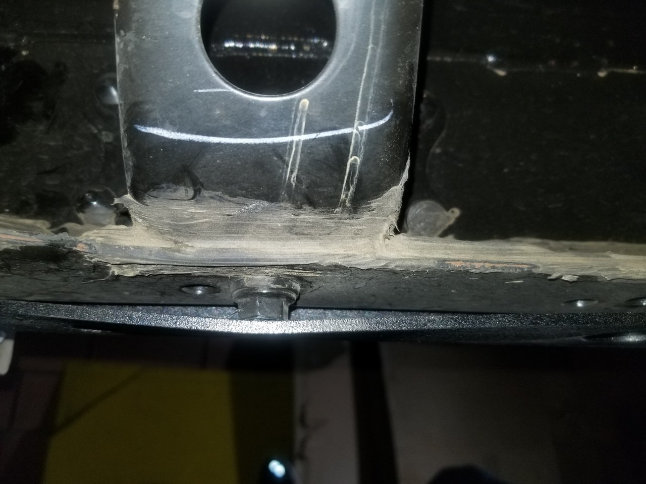

    Anyone run into this problem, Where there is a bolt on the bottom of the frame? There doesn't seem to be a cut out on the sliders for them. Seems almost impossible to get them flushed... the bolt holds a brace? For the drive shaft? Sorry I don't know the exact name for the center looking pipe. :crapstorm:

    Were they still able to be installed with that bolt, or did you figure out a fix. I have mine waiting to be painted and installed.

    I ended up drilling and filing a hole to accommodate the screw but it took me almost an extra hour or so because all I had was an old drill and hand tools
