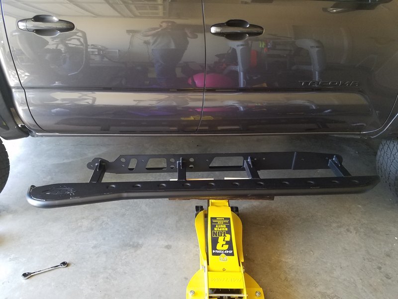

  12. Mar 6, 2017 at 5:18 PM
    #52
    c4lvinnn
    c4lvinnn Well-Known Member
    Sep 30, 2016
    #198603
    2,128
    '17 TRD Off Road DCSB
    Sliders are here
  13. Mar 11, 2017 at 12:54 PM
    #53
    c4lvinnn
    Sep 30, 2016
    #198603
    2,128
    Prepped and painted one slider
